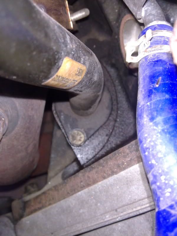

    was looking over the car today an noticed a small amount of oil around the bottom of the pipe which the breather from the rocker cover attaches onto, is this the oil return that people mention?
    this is the offending pipe
    no its not the oil return pipe fella i dont no what that pics called
      bugger, gonna give it a clean down see if it is leaking, could be old oil from where my turbo was changed this week if not i'd imagine it'll just be a seal
        NO, its the block breather, which connects to the rocker cover,
        the oil return pipe referred to above is here - see the two bolts holding it ( shown on a leaky Corsa );

          they bad for going? first ive noticed has only been since my turbo was changed, surely vauxhall would have noticed it while the turbo was off
            Sure are and the dip sticks are sometimes know to spilt
              cheers, glad its not the oil return by the looks of things, I'll get the new parts priced up
