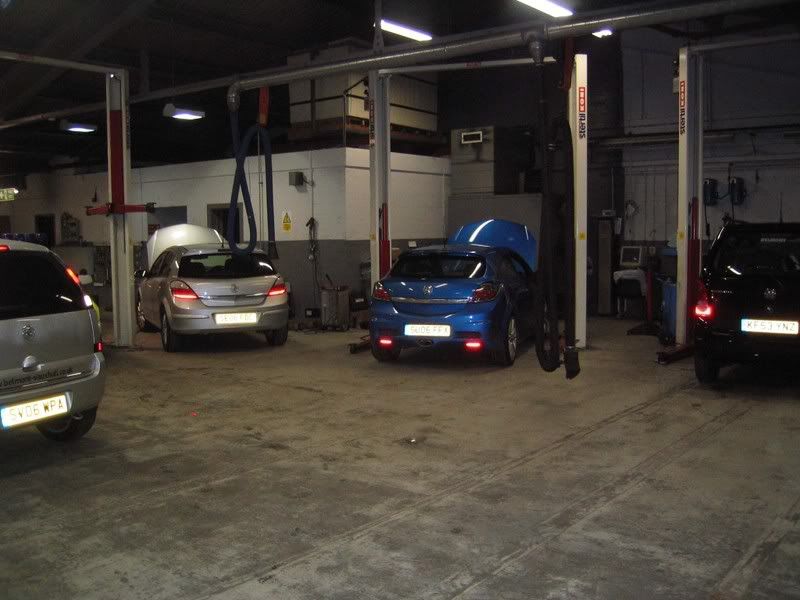

    Decided just to get Vauxhall to fit my exhaust and change my oil but they have come across a problem. They cant get the tail pipe to sit right and are sure the end piece is welded on squint? It tilts down at the passenger side and the passenger side sits further in. There was also two blobs of weld on the tail pipe but said I wasnt too bothered since its not visible when fitted. There going to get their demonstrator on the ramp tomorrow and have a proper look at the milltek on that as after a quick look it seems perfect.

        the dealer is going to contact them tomorrow but I will leave the pictures up for both the dealer and thorney to see to advise
          for information its the pre-cat pipe and cat back they fitted. They come very well packaged so would be surprised if it was damaged during transit

                  right my replacement backbox arrived in at vauxhall last week and was fitted this evening but it was the same as the first, maybe a touch better but still bad. They put there demo on the ramps and compared everything but nothing obvoius so took the backbox off of that and put it on mine. It seemed to sit fine, a little low but that is alot easier to sort than being squint. Anyway just to see they put my new replacement one on the demo car and it sat squint. Am I just having bad luck and got another faulty one? Please people with millteks put up pics so I can see how they generally sit.

                      The silencer shifts under expansion and can end up in a different position,
                      The best way is to fit the system sealed but not tottally tight, run the car up to temp, position the exhaust ,clamp up tight and run again some tweaking of the hangers on the car maybe required, it takes time to get right and they can still move at a later date.
                        Jig was changed from the early builds so not aware of any issues now. As David says they can move with heat. Happy to supply another one or refit for free (appreciate that distance may make that hard for you).

                          The garage has another cat back system on order (should be in any day they say) so once they have fitted that to the customers car they are going to decide what to do. The car has the pre-cat replacement pipe so I thought maybe thats been fitted at the slightest wrong angle but it looks in the exact same position as the standard pre cat but there is flexi pipe in the cat so shouldnt really make a difference. Will keep you posted but if people can get pics up I would appretiate it.
