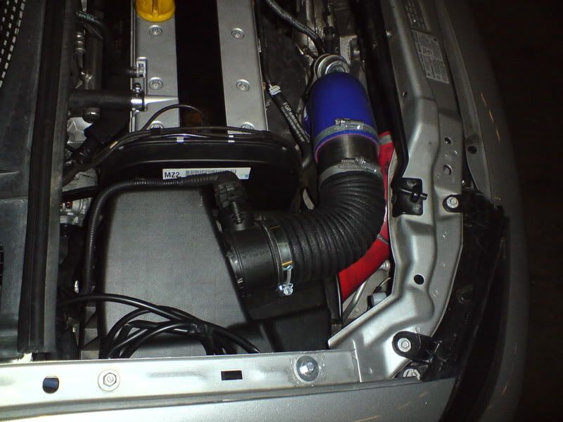

HOW TO fit a 1.9cdti airbox mod for VXR
  • HOW TO fit a 1.9cdti airbox mod for VXR
    http://www.merlinmotorsport.co.uk/SA...559/index.html
    the pipe work is from Samco Xtreme as its 3mm vs 5mm the std Samco is
    Samco Xtreme 90 degree reducing elbow 80mm to 60mm bore is used to Bolt onto the Turbo
    then get a bit of 80mm Steel or alloy tube I got this from a exhaust company
    then a Samco Xtreme 90 degree 80mm from AFM to the pipe joiner

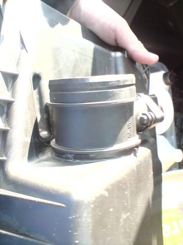

    I have used a small bit of samco 80mm 3mm wide an a 80mm clip to Hold AFM into airbox
    I have used the Black stuff as i had that in work an it looks more oe I think
    hope this helps some one thanks

      have you the vxr maf then
        pipe work was £40 all in
        and the airbox was £40 off a vauxhall parts company
        they are only £60 from vauxhall with a new airfilter

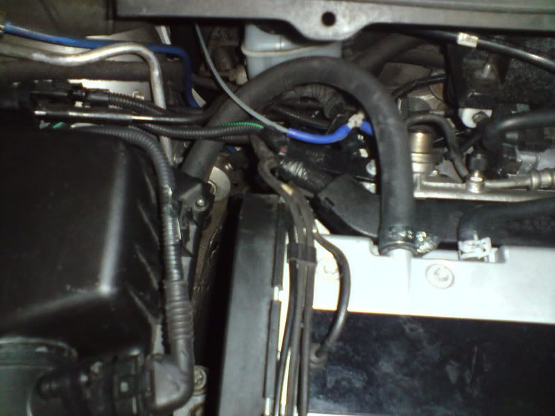

        also the breather is in the bottom of the airbox with a bit of pipe 17mm off top of my head
        that was from work again but should only cost £4 from a hose company
          yes along with the engine an gearbox

            looks ok but the jobs from percy look better.....how have you fixed the maf to the airbox mate
              Inside the airbox the maf has a 3mm ring of samco around it and a 80mm clip holding that in place no probs at all

                ok mate i get u.....
