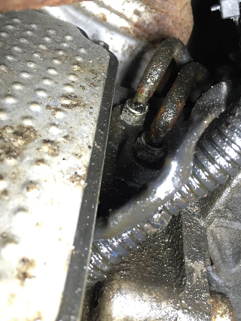

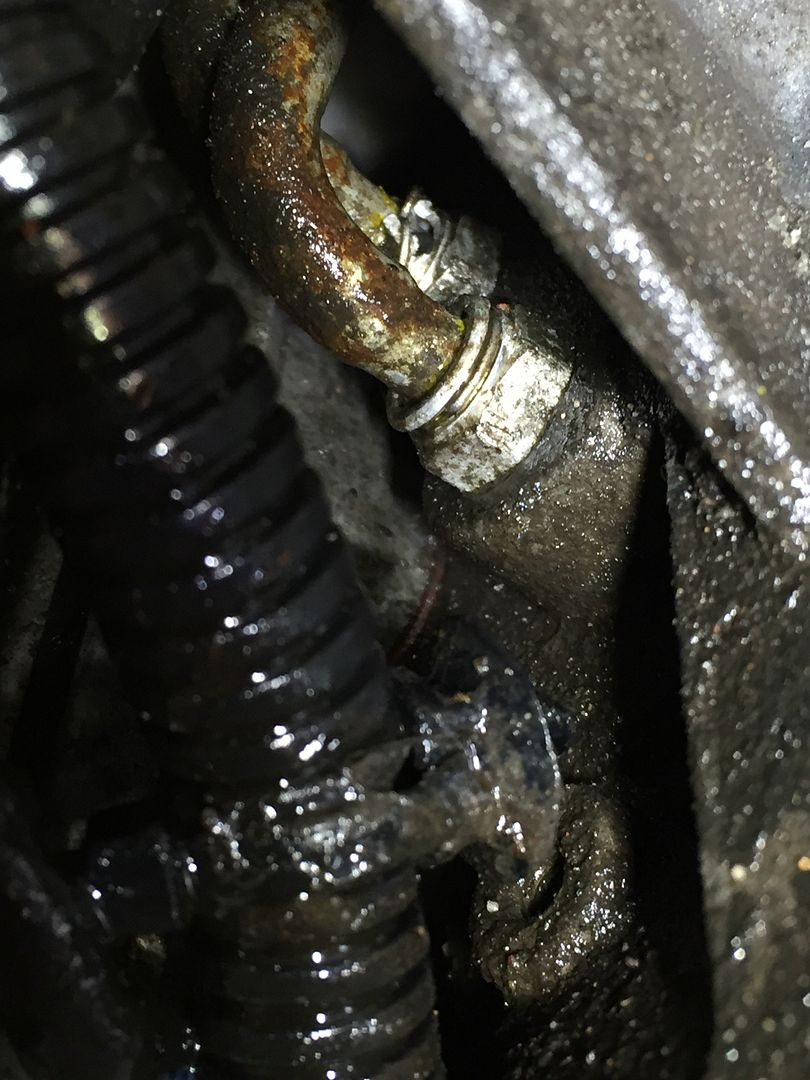

    Insignia went in for it's rear diff oil & filter change, but mechanics found further issues.
    One of the bolts has a chunk missing & it's forced the seal out, it's leaking oil!
    Photos below.
    Currently awaiting confirmation from warranty.

      I am hoping the diff is alright! still awaiting confirmation from them as to whether it's covered or not. bloody well should be!
        Obviously a mechanical failure! A bolt breaking off can never be wear and tear...

                    well hopefully it'll all be sorted but I'll see how we get on - I will try keep it, however my mechanic said it just looks like one of the cables that need replacing - apparently only come in pairs too !

                        Yeah if you manage to get the diff it can be reconditioned unless it has ground itself to bits. Let me know if you get it as I may buy the failed unit from you as a spare or swap for some bits I have left over like second cat delete.

                            Update
                            The warranty company have been in touch & want to send an engineer out to inspect the vehicle asap. It'll be inspected at my usual garage & I'll be present too.
                              Further update
                              No engineer available anytime soon, so the warranty company had no choice but to authorise the repairs. Parts ordered, can take up to 10 days to arrive
