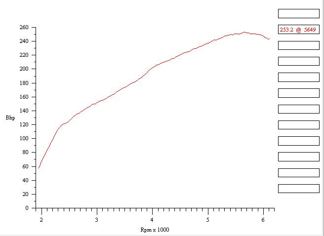

    So the Vectra has been sent to Courtenays for the start of the mods. As there is only 1,800 miles on the car it was a good idea to check the BHP and Torque for readings. The air temp was at 23 degrees and the runs where consistant. It was pleasing to see the figures where spot as per the VXL figures and this can be used as the base line now. I guess after a few more miles on the clock we may see some minor increases.
