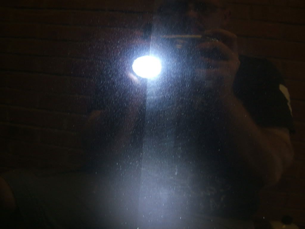

    heres a little vid to showing how bad my paintwork is ( was )
    http://s305.photobucket.com/albums/nn208/dwmc_2008/?action=view&current=DSCF2138.mp4
    and a quick pic

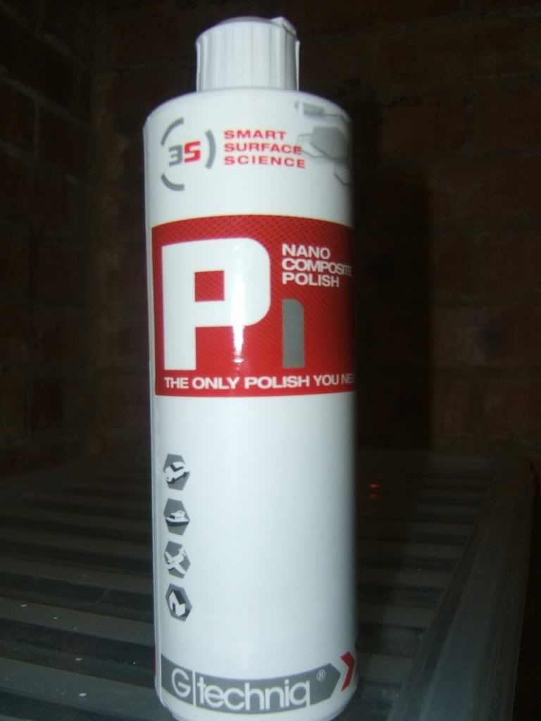

    using an SFX2 pad and P1 polish
    tomorrow i`ll be using same polish on the SFX 3 pad followed by the SFX 4 pad . it`s a great all in one polish but the only downside is the dust it creates . just needs an extra spritz now and then ( edit-once i got used to the polish theres no dust or splatter anymore )
    would of took a few more pics but once i got started i just kept going
    details of polish here >> http://gtechniq.com/shop/3s-for-cars...posite-polish/

        the P1 polish is great as an all in one as i tried it out on my bonnet on different pads last week before bonnet got resprayed . but i will be honest when i say it creates dust a wee bit more compared to megs . although that could be down to me as i guess after a few uses i`ll get used to it
          heres a liitle vid once i`de finished the full door
          http://s305.photobucket.com/albums/n...t=DSCF2137.mp4
          this was just to check for swirls and not aimed at reflection as they`ll come once the car is finished

            That second video really shows the metal flake up in the paintwork, good result's

                  Daz mate if you want to keep some of the dust down use a sqwirty bottle with warm water in and keep the pad moist and that will help to keep the dust down a little but may give a little pad slinging, i know all about this using farecla as its right messy.
                  I tend to put the material on the panel and spread with an applicator instead of on the buff pad as that keeps the pad sliging down as well.
