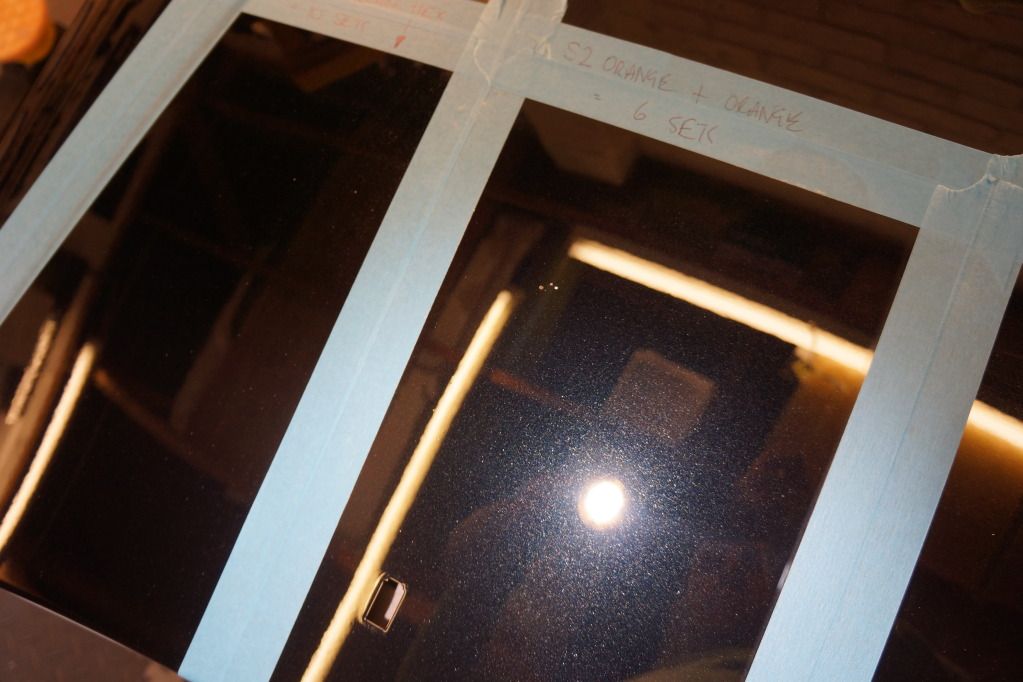

    The sections all marked up at the end to inspect and discuss the different finishes achieved for look and clarity.
    Scratches between sections..
    See how light throws off and creates the colours on the rid edges.
