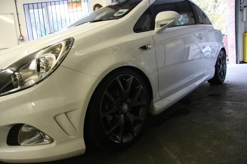

    Ok me and Macca went up to see LeeLee to pick up some bits and have a play with the Corsa... Wasnt too sure about white Vauxhall paintwork because i havent spent much time on it before *cough cough* so just did in one day what i did on mine in 3 weeks..
    What a fantastic car and looks superb so much that someone i know wanted to sell his veccy for one

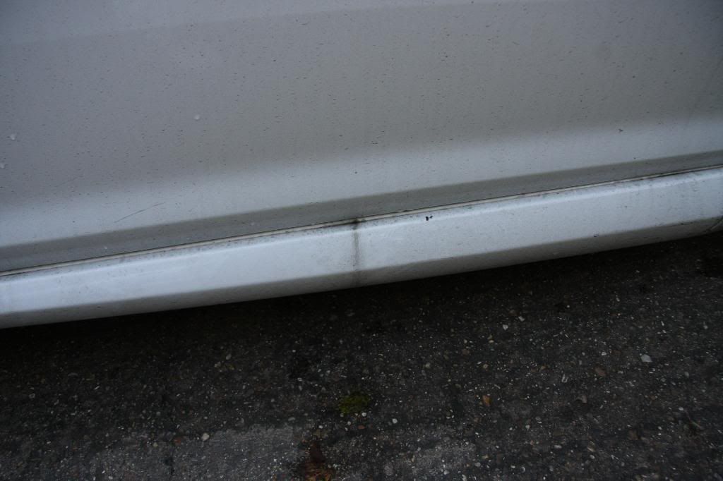

    Car dirty
    Transport wax love it in the sills running out continually

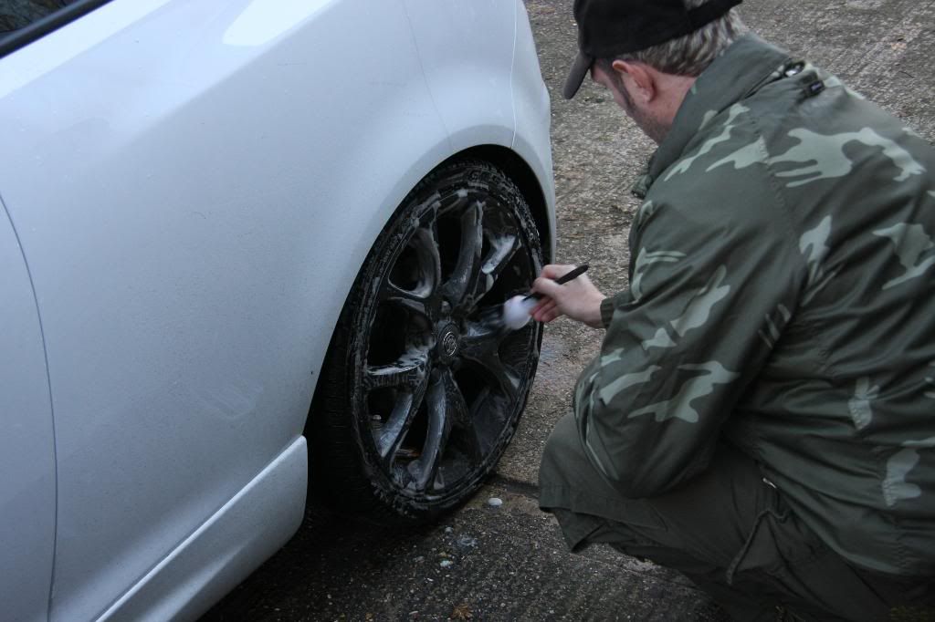

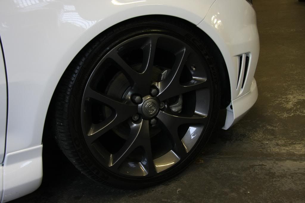

    Wheels cleaned with zymol wheel cleaner a pepperminty smell but in my opinion not very strong but good enough for these wheels today

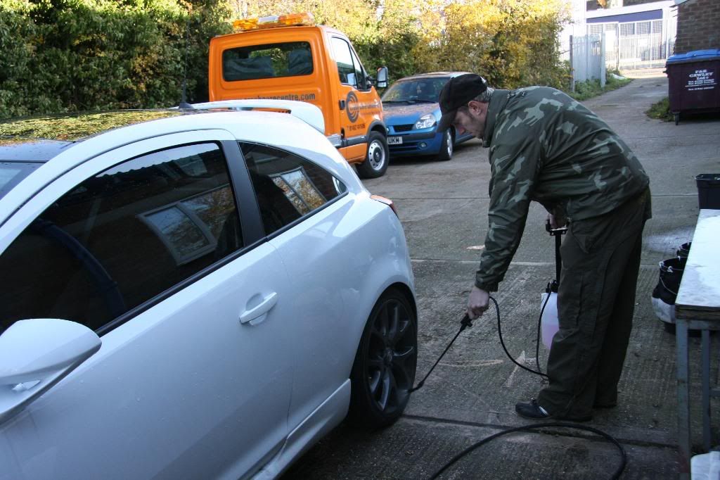

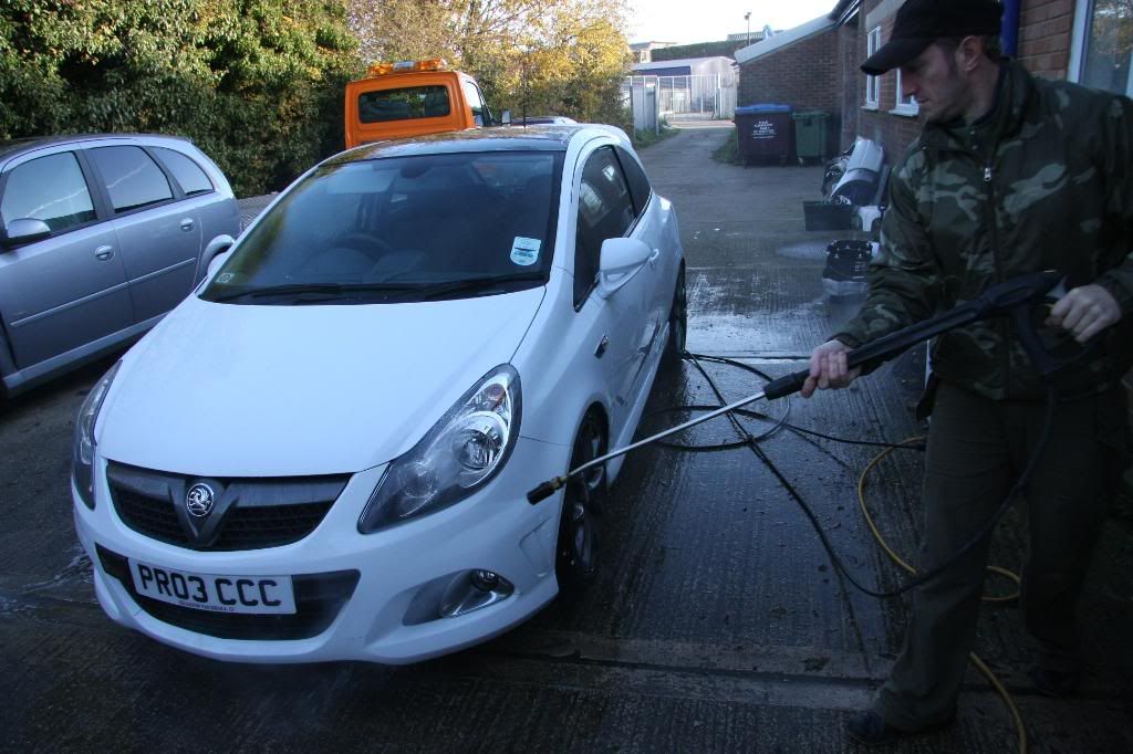

    car then sprayed off , no snow foam today as not really needed

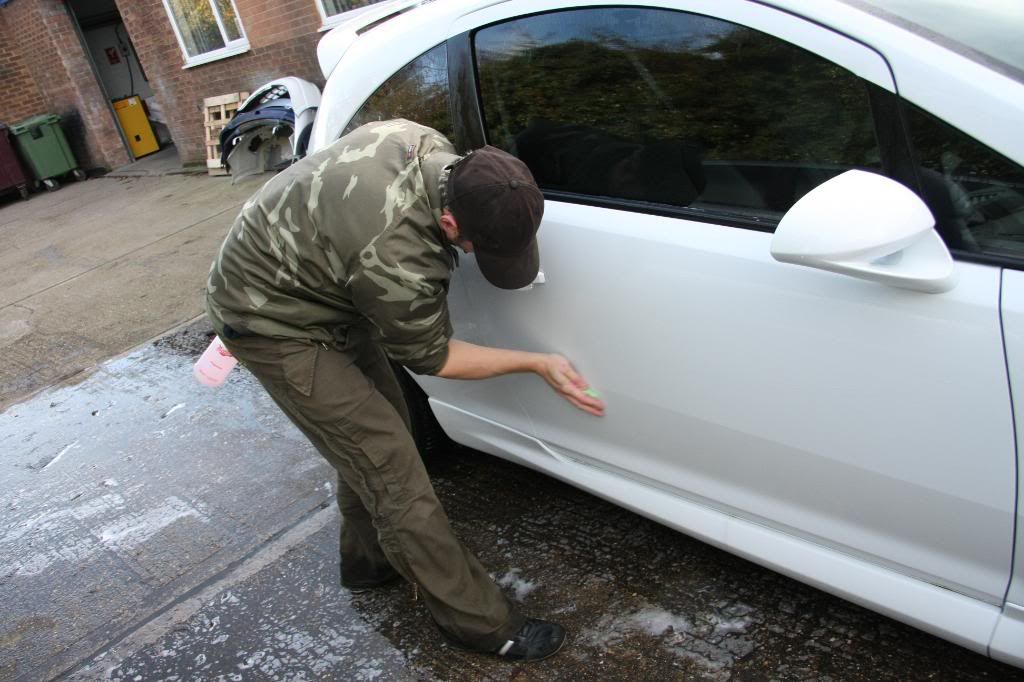

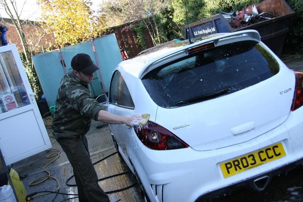

    Car washed off with zymol sponge and 2 bucket method using chem guys maxi suds shampoo
    then sprayed off and clayed using maxi suds as lube and sonus green claybar

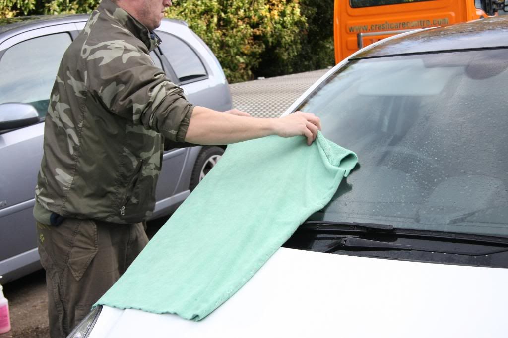

    Car then dried

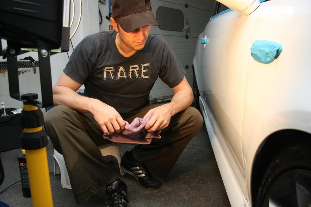

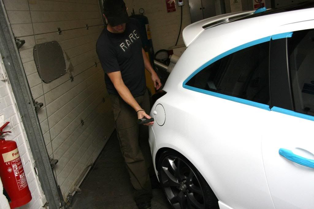

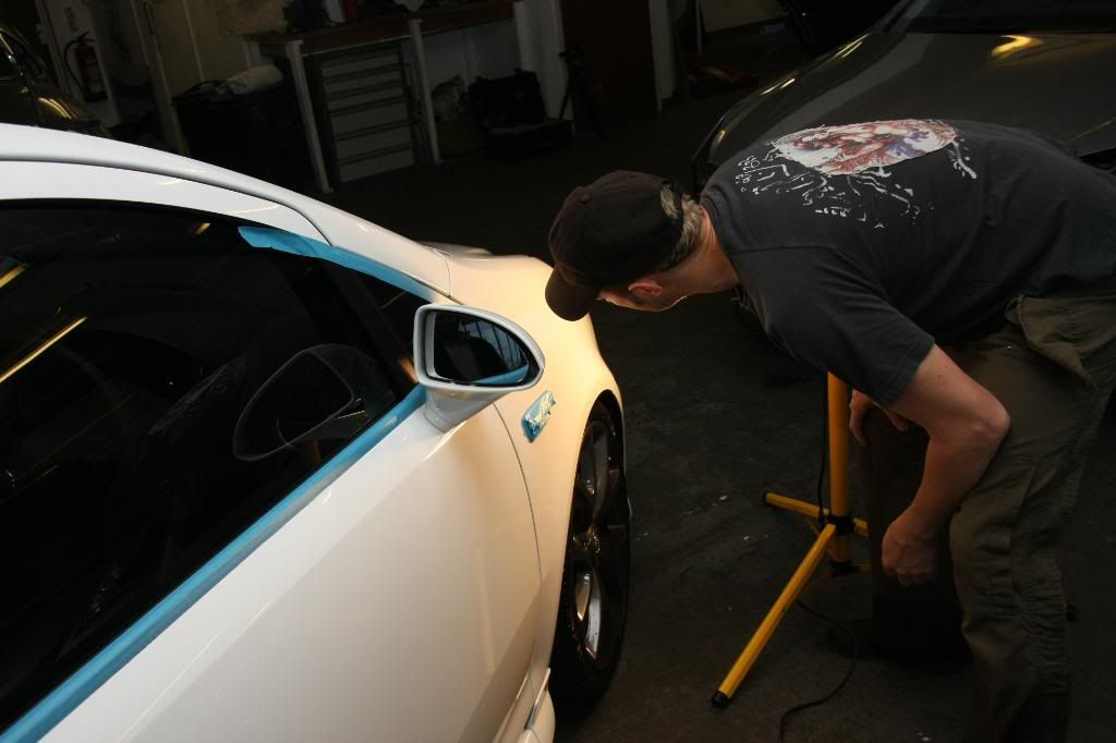

    and taken into LeeLee workshop for masking up

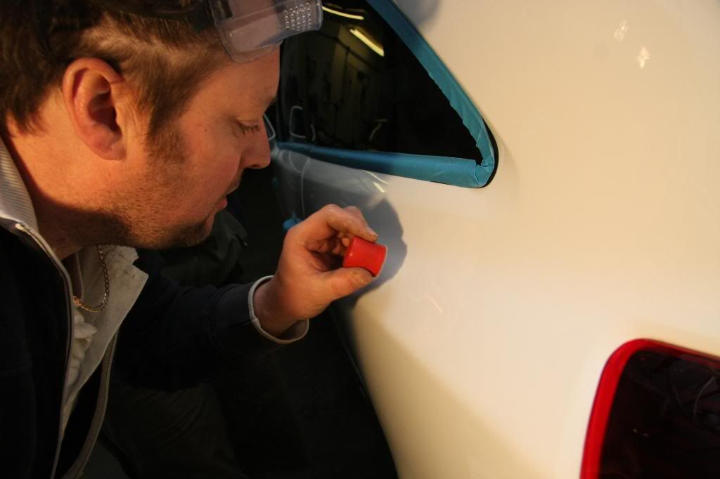

    Paint readings taken approx 130 to 140 across the board

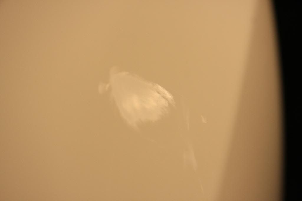

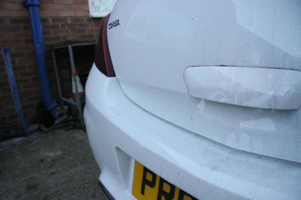

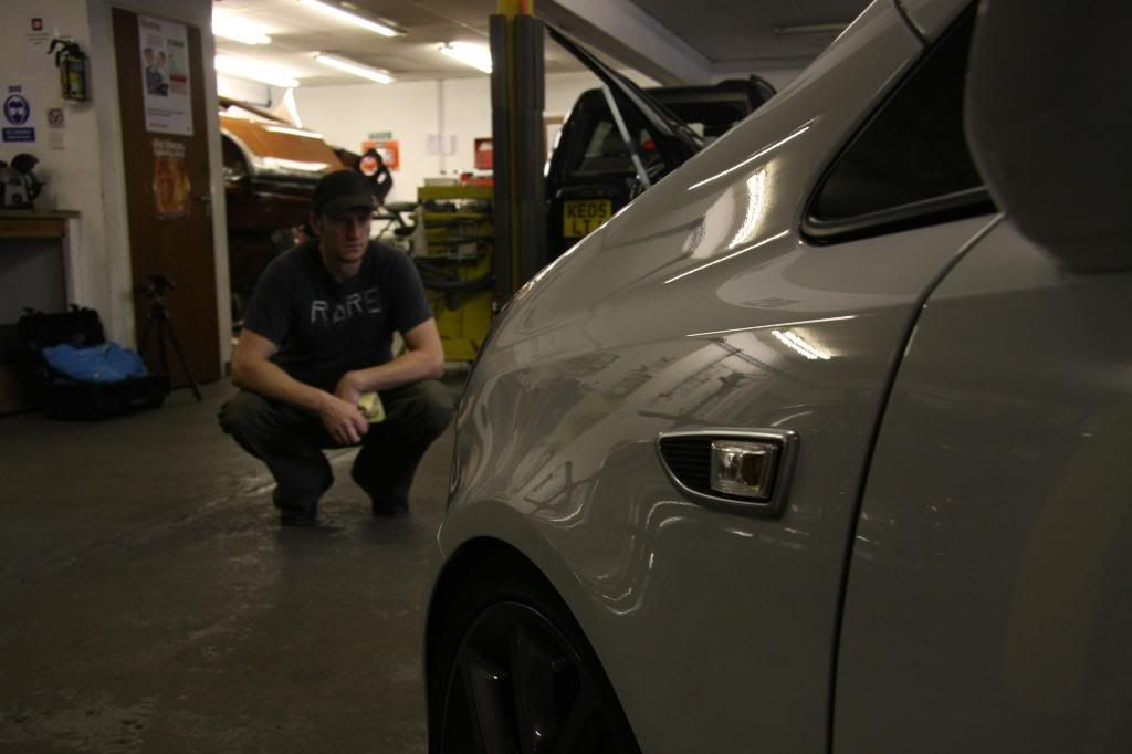

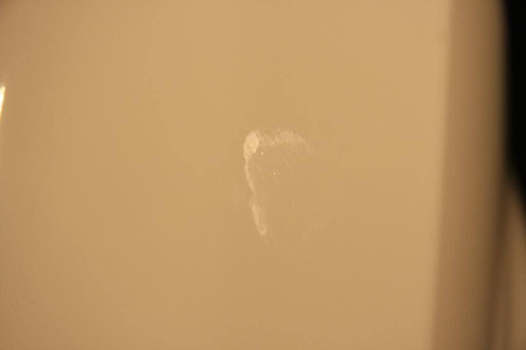

    Paintwork inspected
    and found this which i didnt like

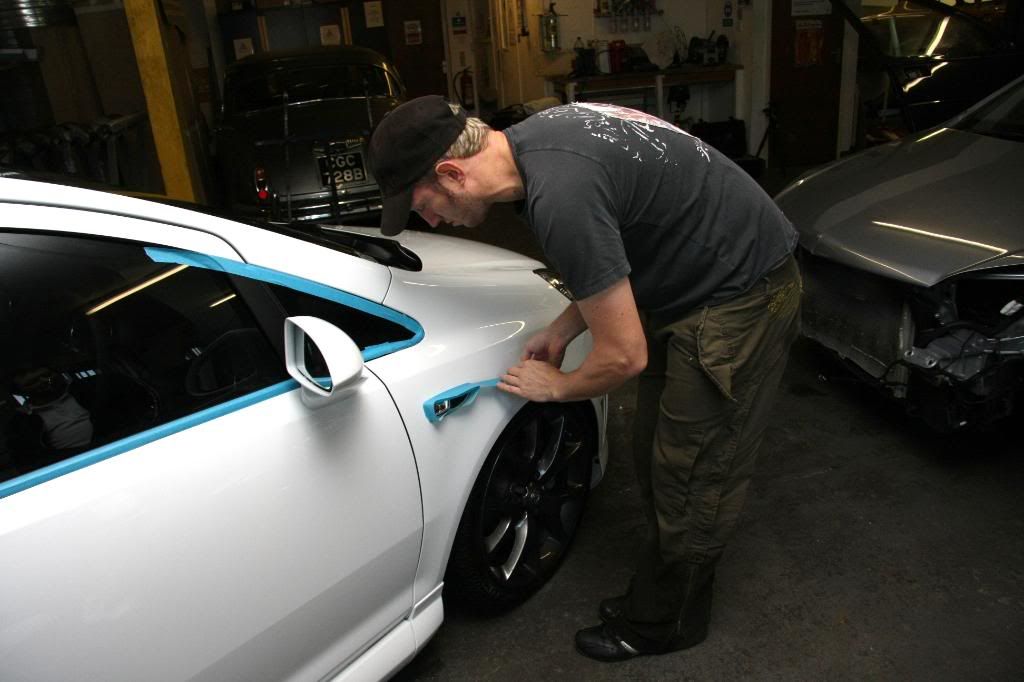

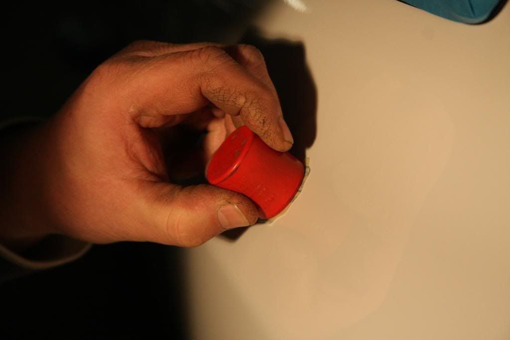

    out came LeeLee daisy disc and the man removed it for me
    LeeLee uses Dove moisturiser and Fairy Liquid and wanted me to point this out
    Once removed

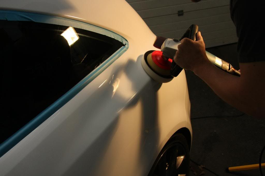

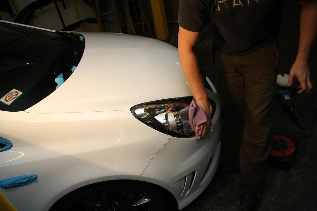

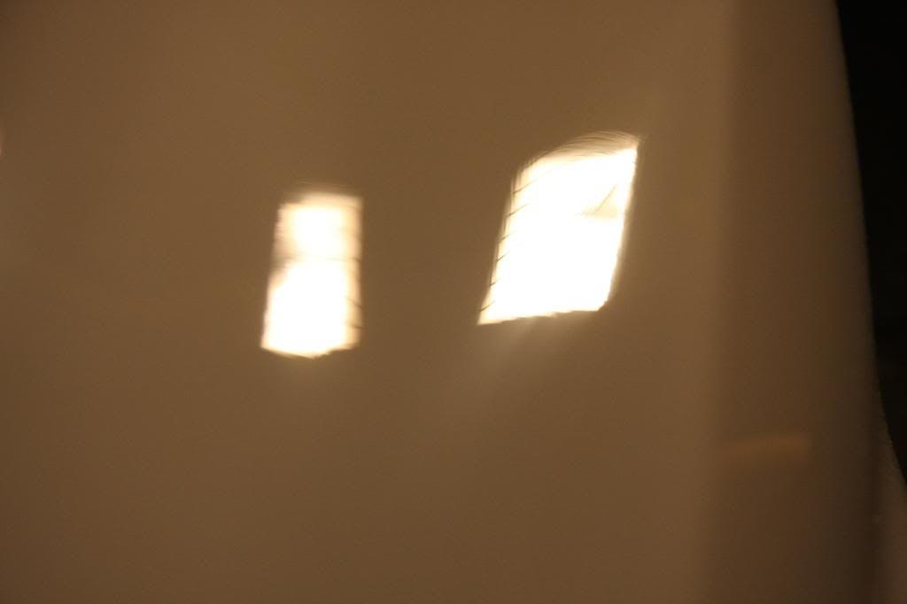

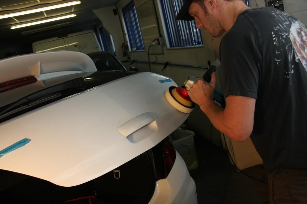

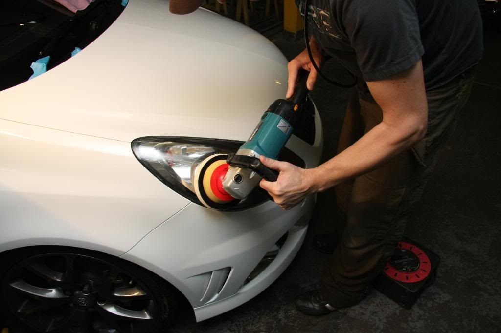

    area and panel machined with 3m fine compund
    then extra fine compound
    then ultrafina allover

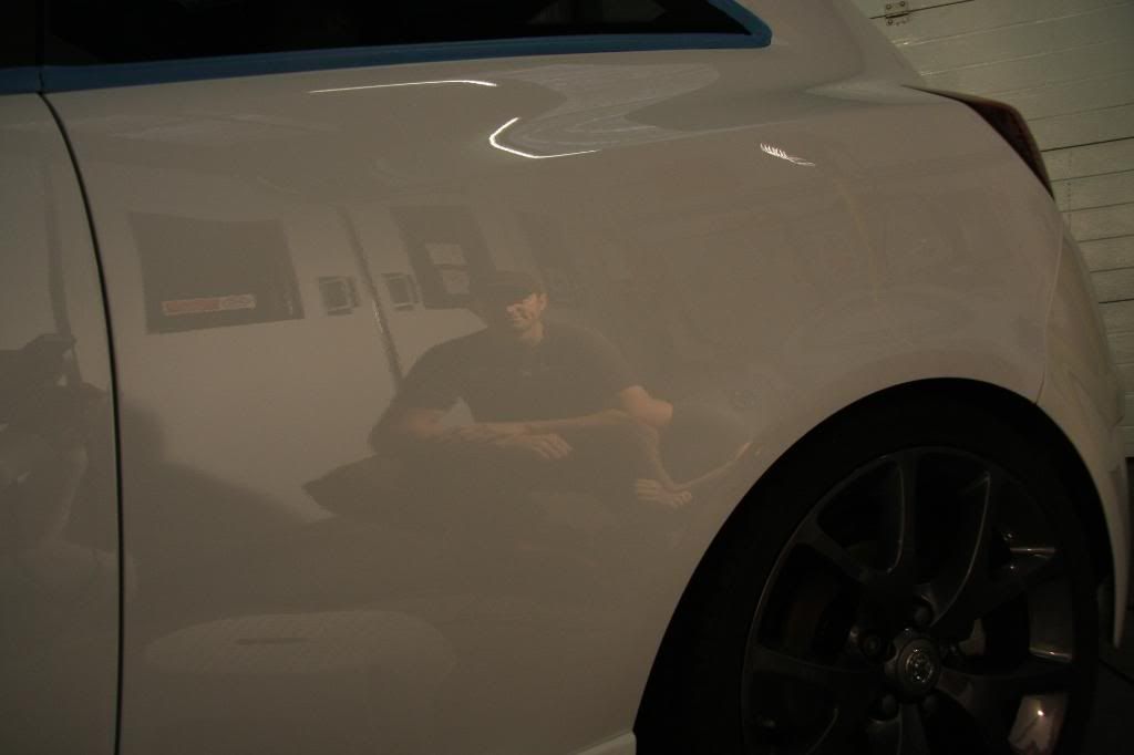

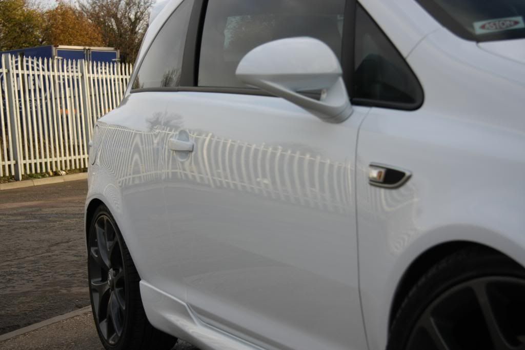

    and the result imperfection free

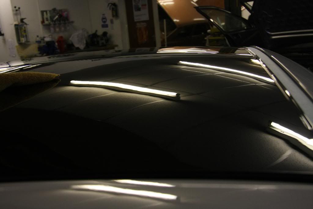

    Rest of car then machined and paintwork corrected

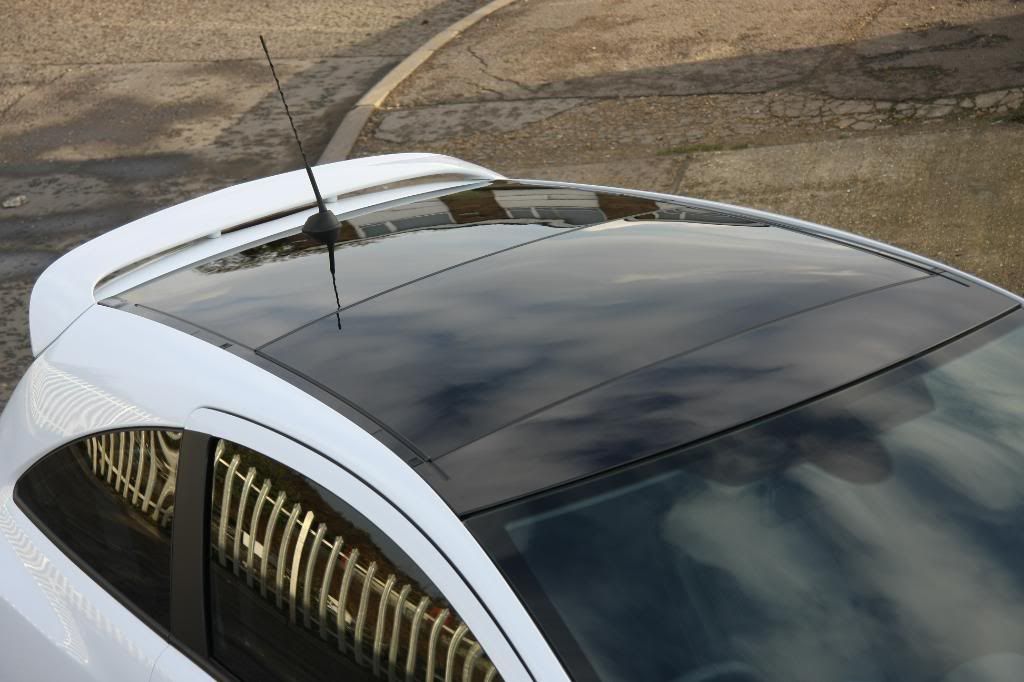

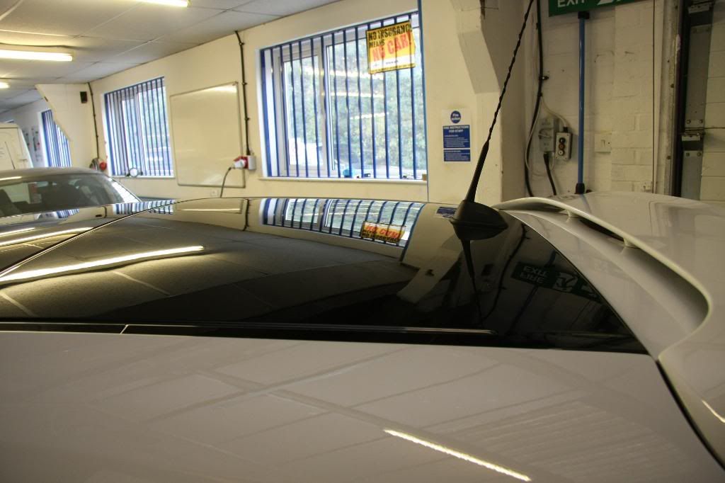

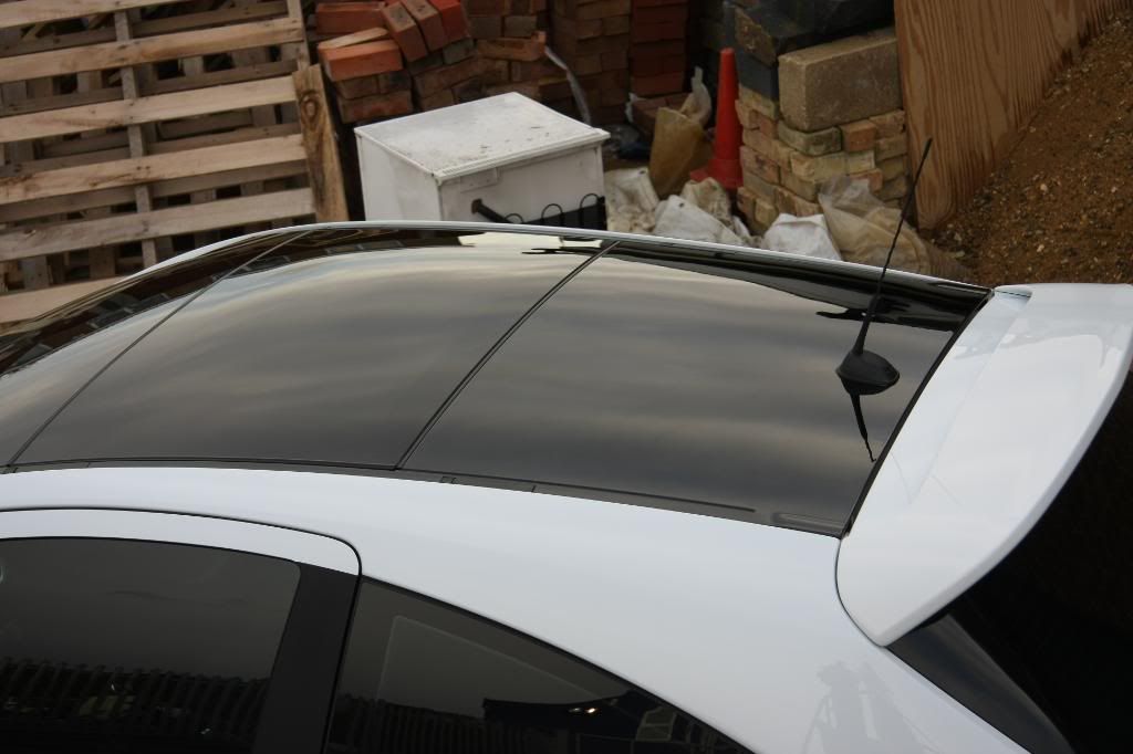

    and gloss black roof came up superb

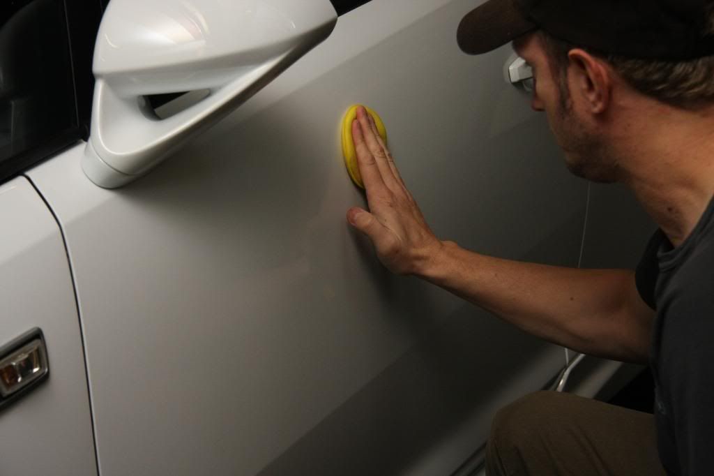

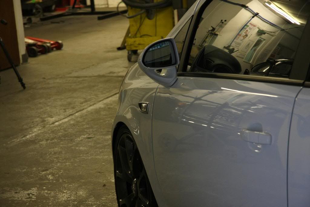

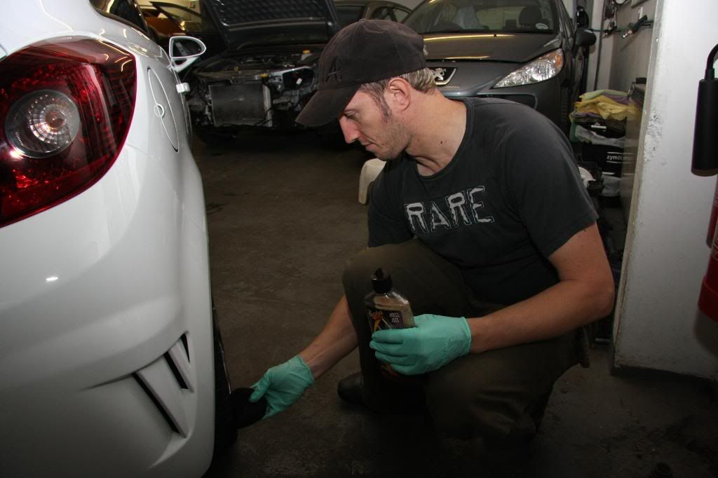

    car then waxed all over and left on for approximately 15 minutes
    Rest of car finished off

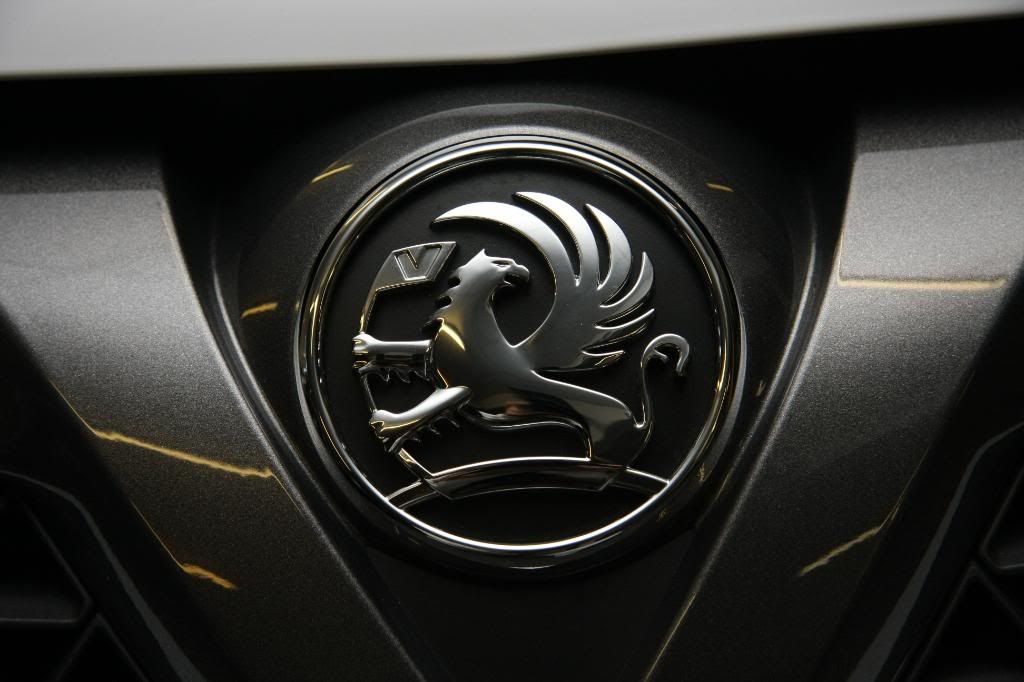

    and finally brushed crevices etc

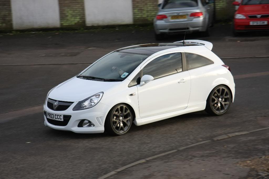

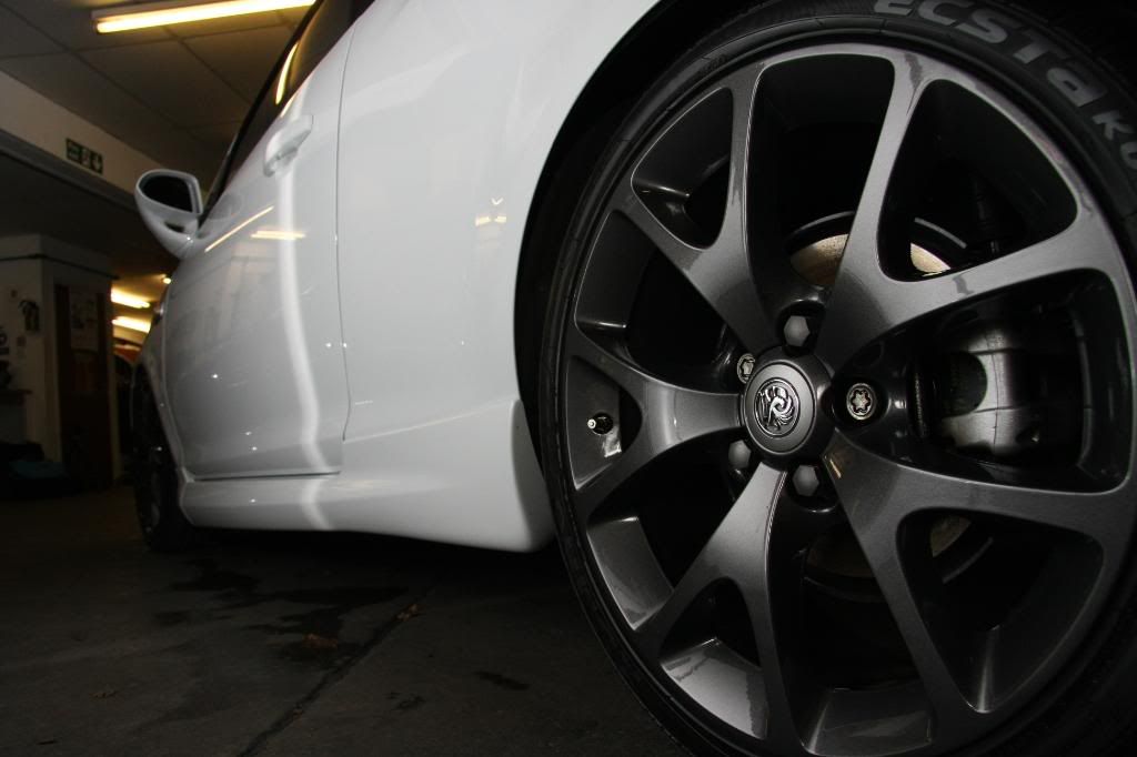

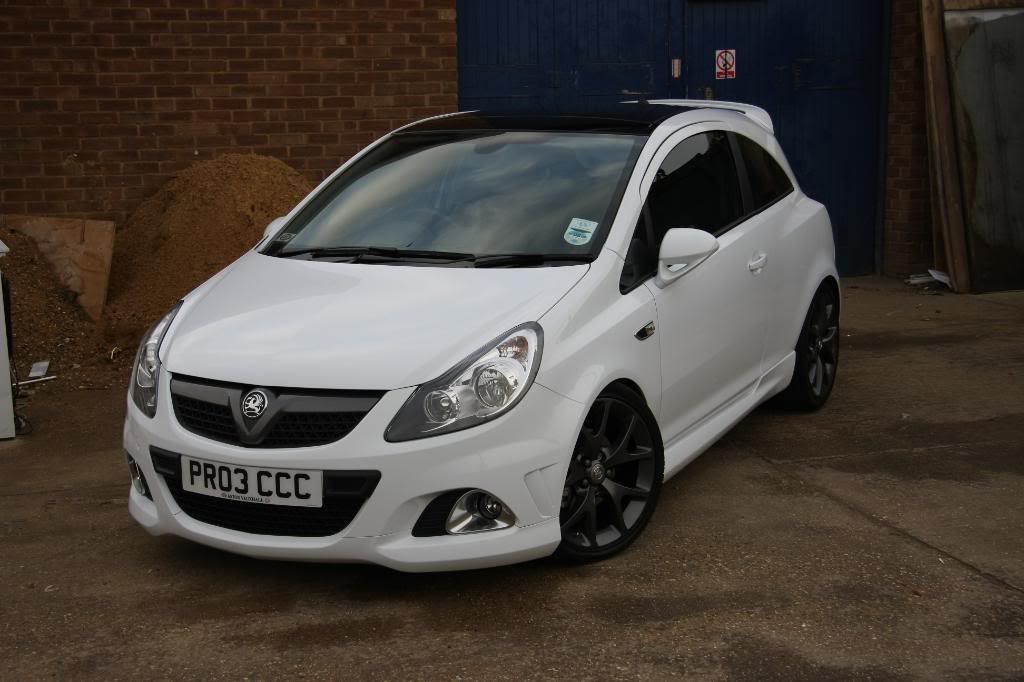

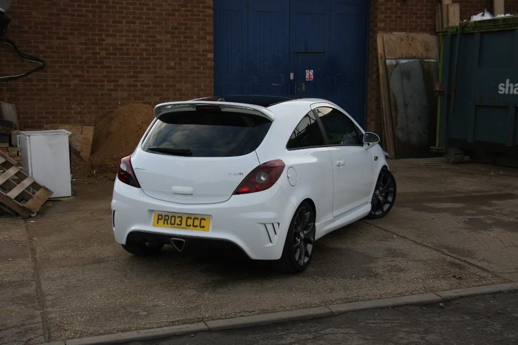

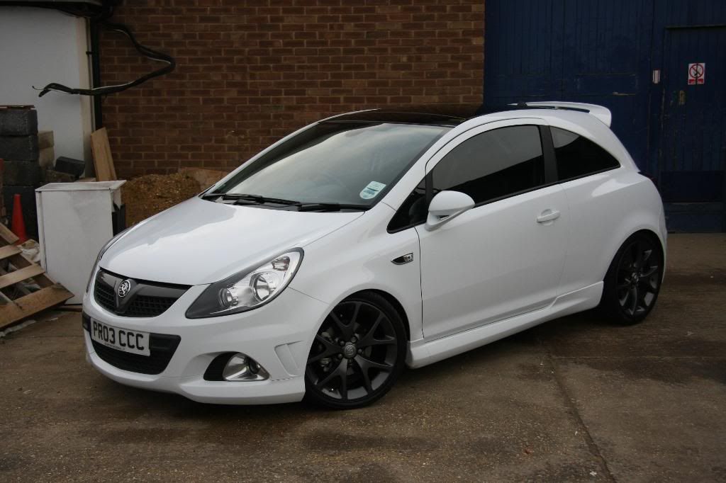

    FINAL RESULTS
