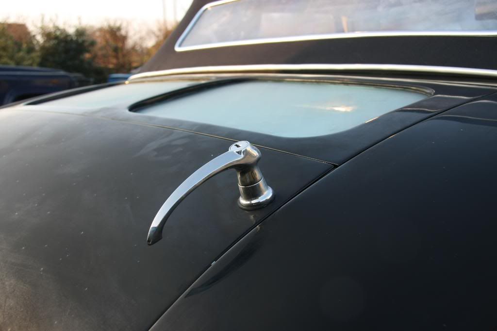

    Now the paintwork on this car was actually alot harder to correct than i first imagined and i really thought it would be like butter but it wasnt the case infact it needed a bit more work than i first anticipated and i also didnt realise exactly panel area how much was on this car when you roll out all the curves it was probably a standard car and a halfs work..
    Anyway i masked up as i went around as certain areas were still damp from the conditions so it seemed the sensible thing to do..
    Started at the rear and worked my way forward , there was no way i was going to do 50/50 shots on this because i had no idea what has or hasnt been done to this car in 50 years so after speaking to geoff i just said safety was my no.1 goal here and i would get the best i felt possible without risking anything.....One thing i did learn today though was that maybe like some i could do with a pc for intricate areas that the makita wouldnt fit into as some areas were done by hand especially behind the chrome fitments and lighting which were unaccesible via machine in any form with any backing plate.

                            The paint is single stage so its just paint hahahaha and yes i did remove some but not alot as some minor swirls scratches remained yet i was erring with caution and working on safety rather than perfection on this car.
                              the paint would be the old school celulose paint which can be a pleasure to work with, and my god marc what a good job you made of it mate! i bet it was a joy to work with paint like that and the finish is incredible!!
                              They used to build that paint up in layers and layers applying 9-12 coats of it and then buffing it back by hand to get a finish on it, the best stuff for it if your doing it old scholl is annonia based polishes, i did a baby austin for my boss when i was serving my time and he got hold of this stuff but i cant think of the top of my head what it was....
