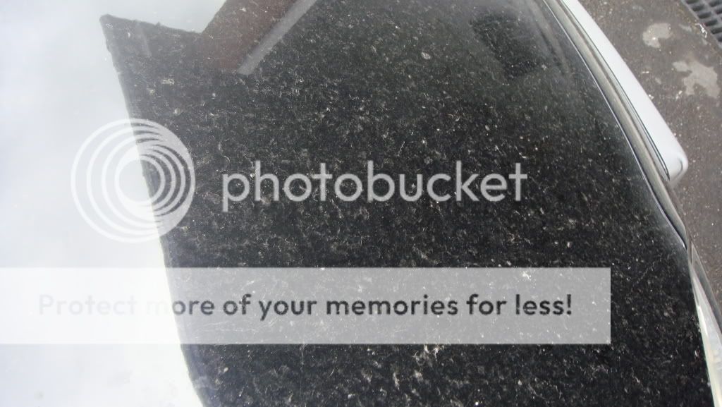

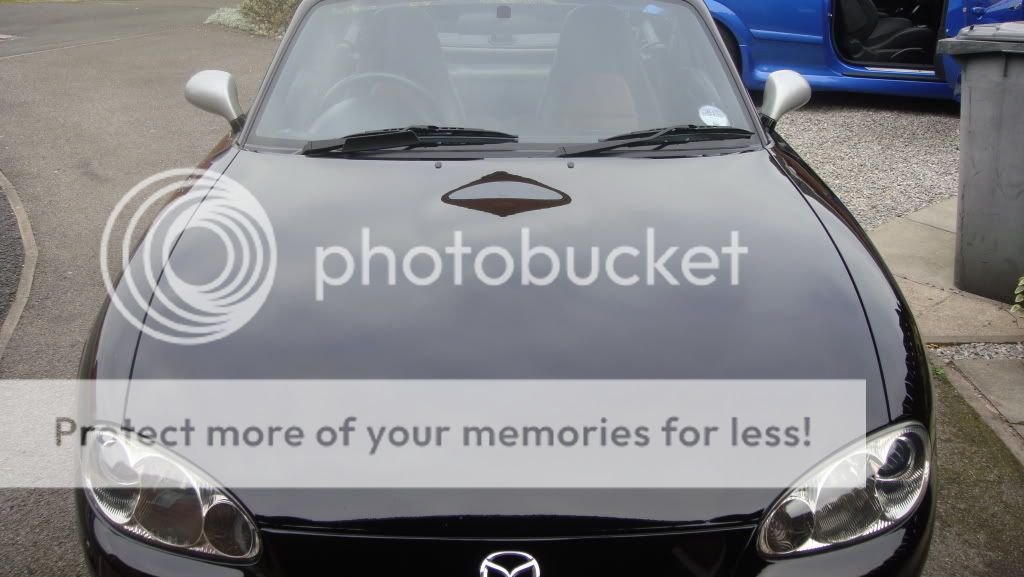

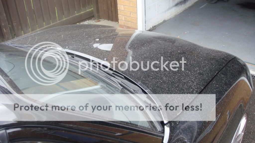

    Well whilst Paul and Jen have been away in Germany having a play at the ring I have been having a play with Jen's black Mazda MX5. Jen has been wanting this done for some time now, just never got around to it until now. This took a couple of days as it needed a fair bit doing to it. So some before pictures:

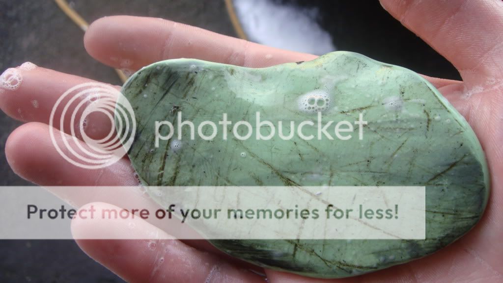

    Clay with Sonus green clay and Dodo Juice Born Slippery clay lube. The clay after doing the roof and bonnet

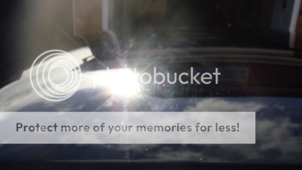

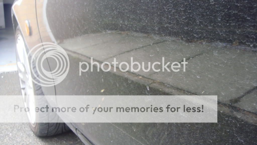

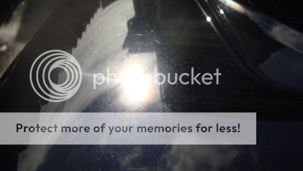

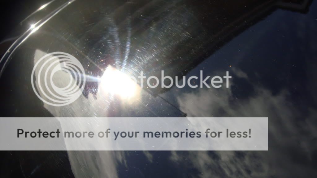

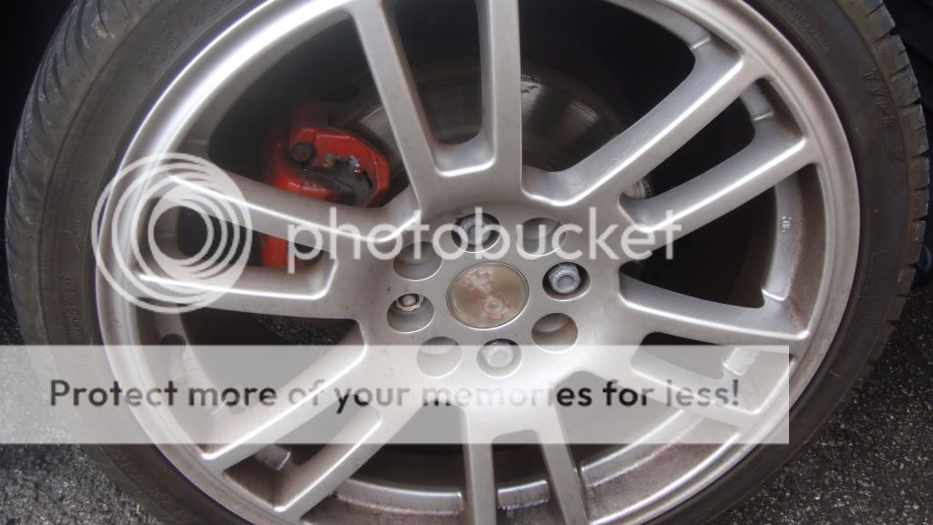

    This left the car nice and clean but the paintwork was looking so flat, no reflection at all. To be honest i did expect this as the car is 8 years old. The sun wasnt out much but managed to get a few shots of the defects as below. The car was heavily swirled and had alot of scratchs but not too bad for its age, ive seen newer cars in far worse state:

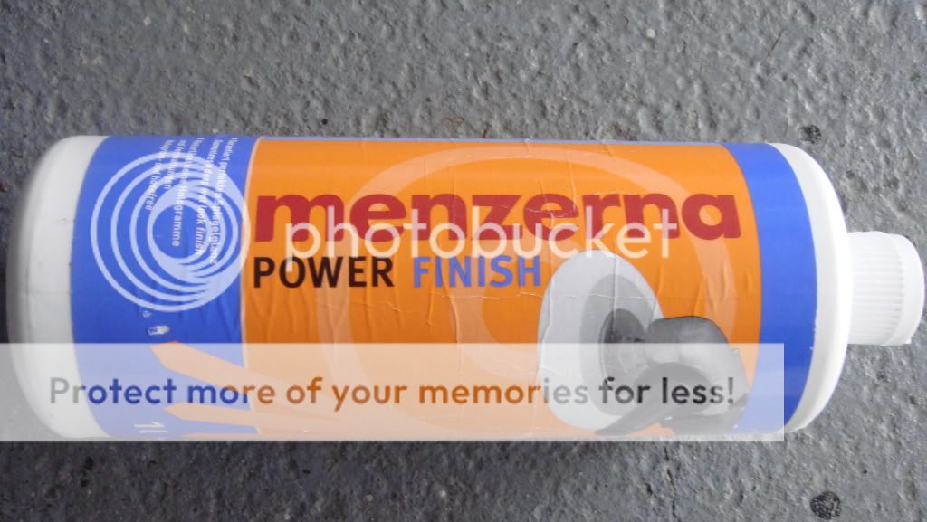

    Next the car was given a good polish using Menz's Power finish using a yellow Lake County pad. Car was polished a panel at a time and buffed off using a microfibre cloth. This had corrected the swirling and some of the scratchs but left the paintwork looking very dull. Next moved onto Men'z 3.02 with an orange Lake County pad, again did a panel at a time and buffed with a microfibre cloth. This soon got the shine back into the paintwork. Between each polish's the car was wiped down with IPA. Picture of the two polish's used:

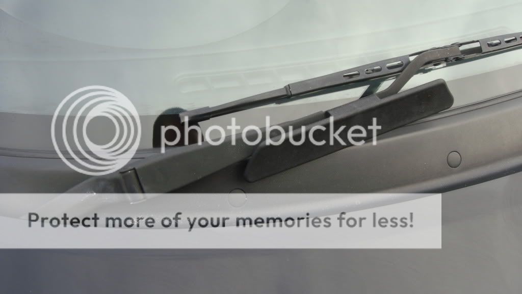

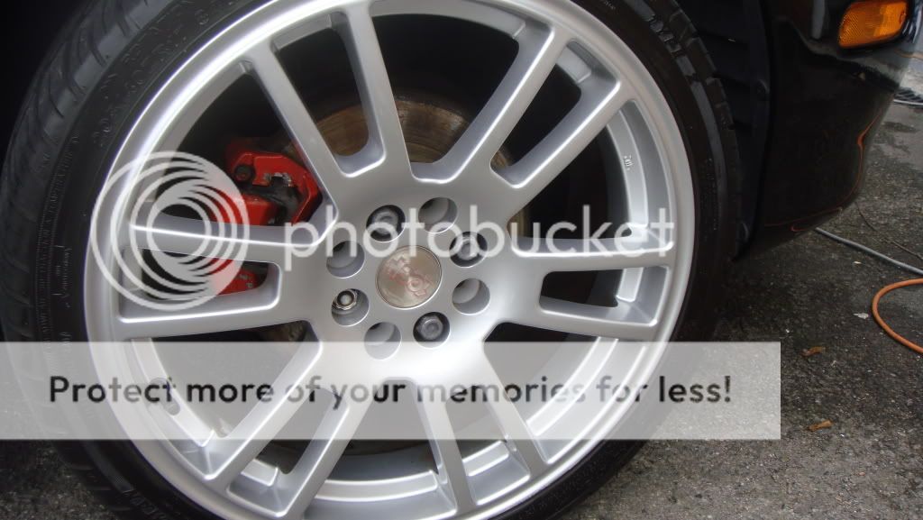

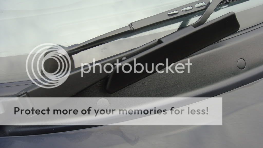

    After applying the three layers of Z2 the car was given a final wipe down with Z8. Next all the door shuts were cleaned with Meg's APC and Last Touch. The interior was hoovered out and the leather cleaned with Z y m o l leather cleaner and microfibre cloth. All glass was cleaned with meg's Glass Cleaner inside and out. Wheels were given two coates of Jetseal leaving an hour between layers to cure and then buffed with a microfibre cloth. All black trims and tyres had Chemical Guys New Look Trim gel applied to them, heres before an after pic, this stuffs great:

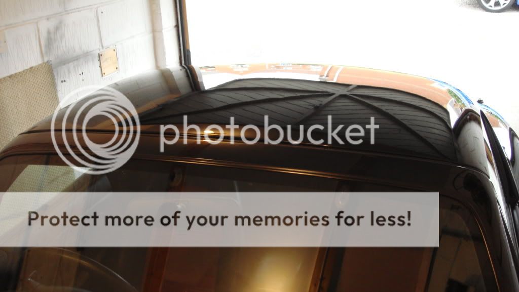

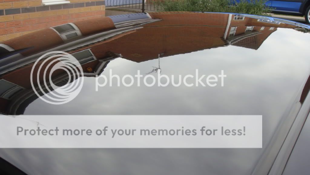

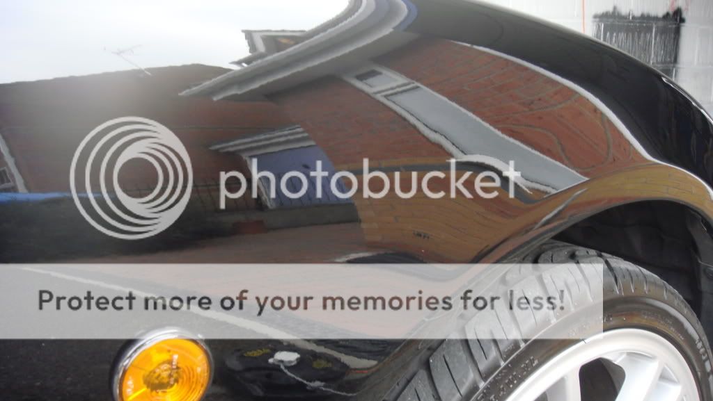

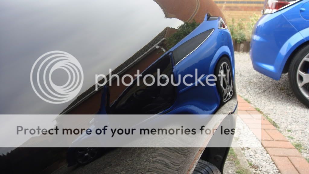

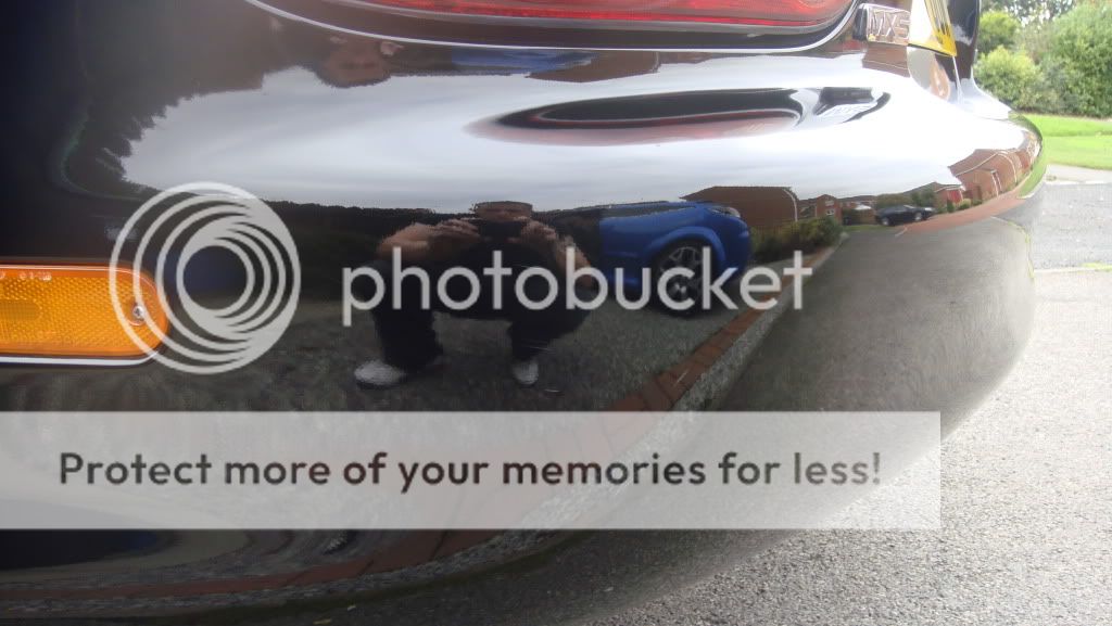

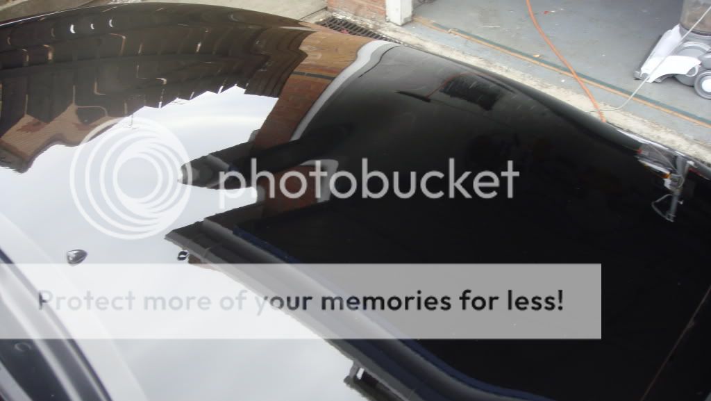

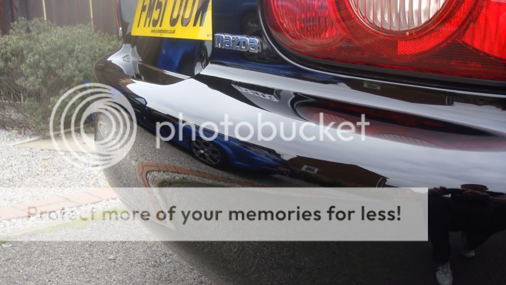

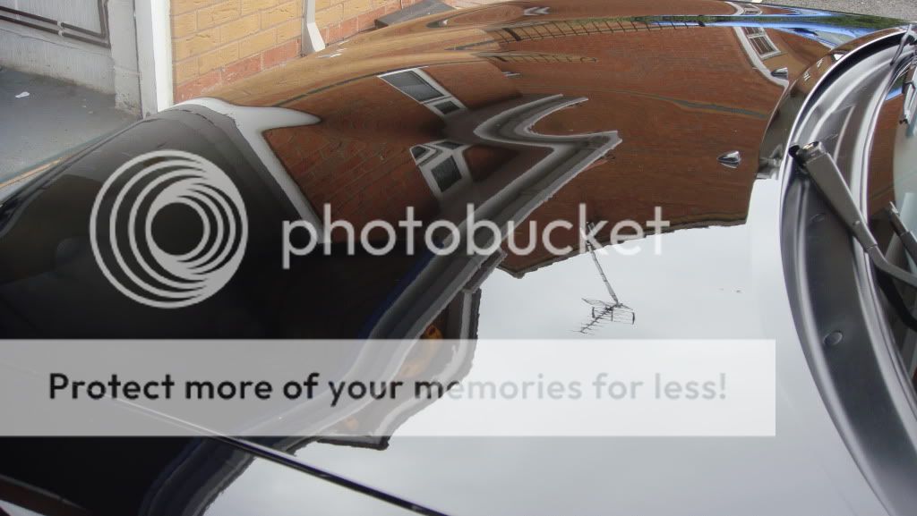

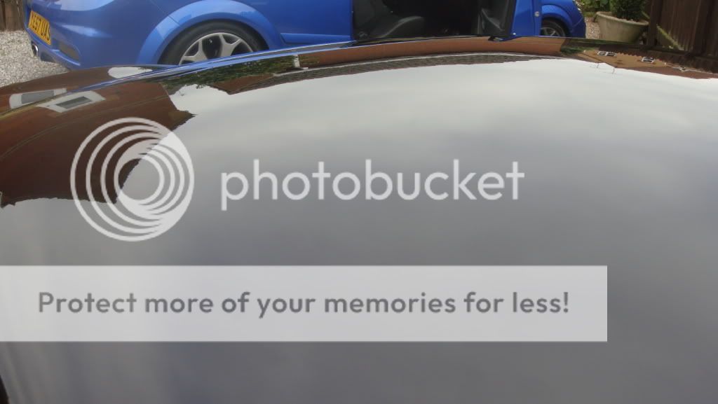

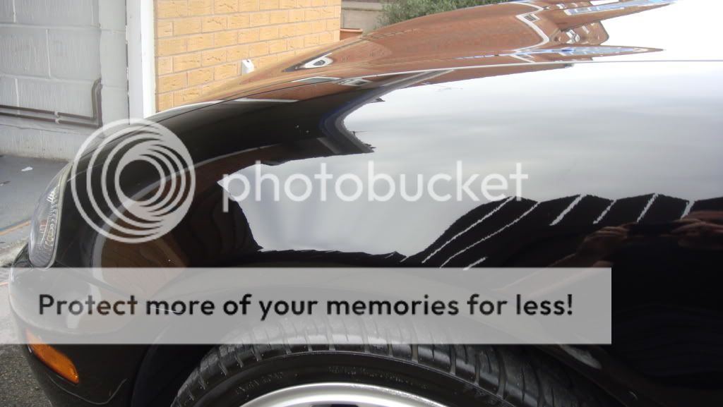

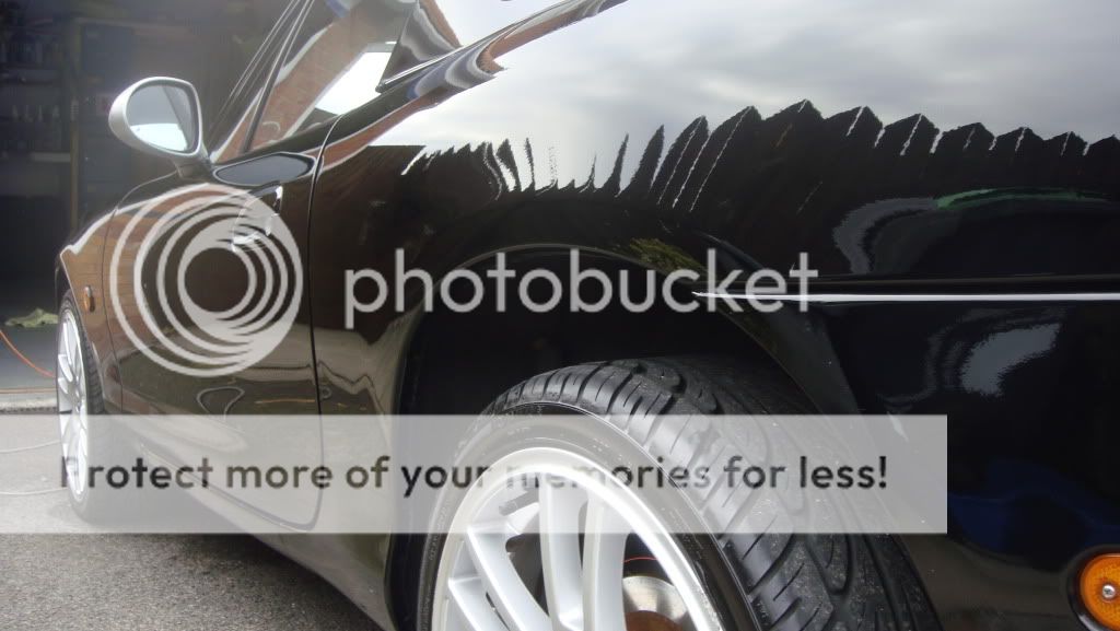

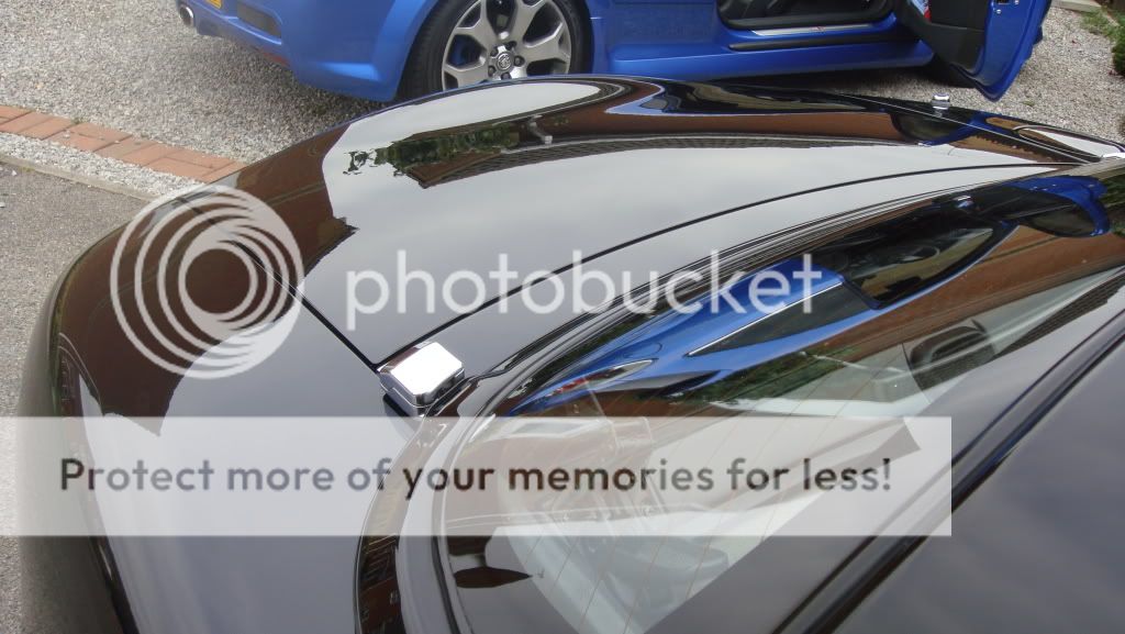

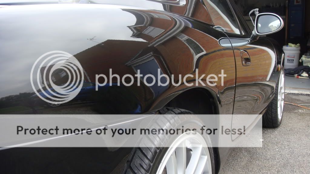

    The final results, unfortunately the sun wasnt out:

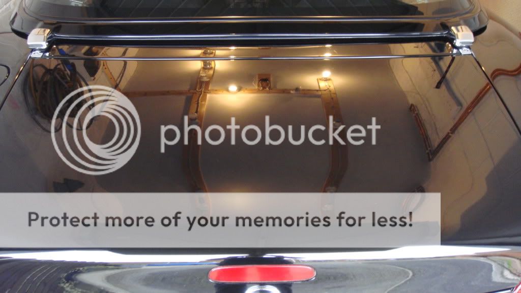

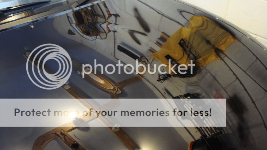

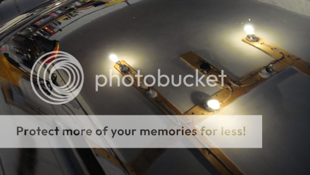

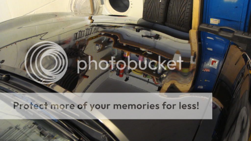

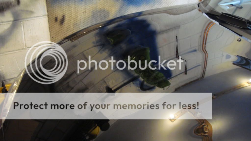

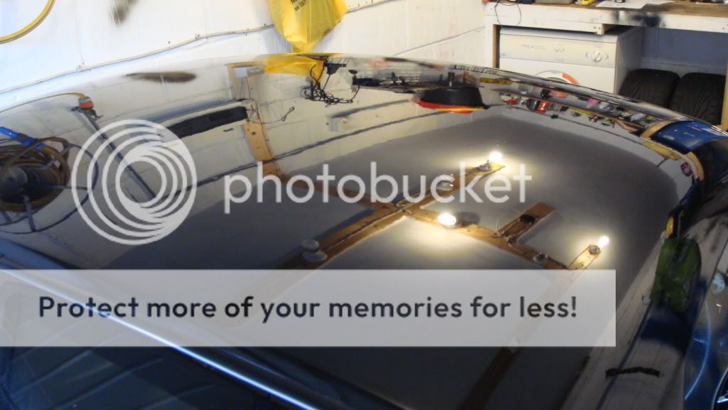

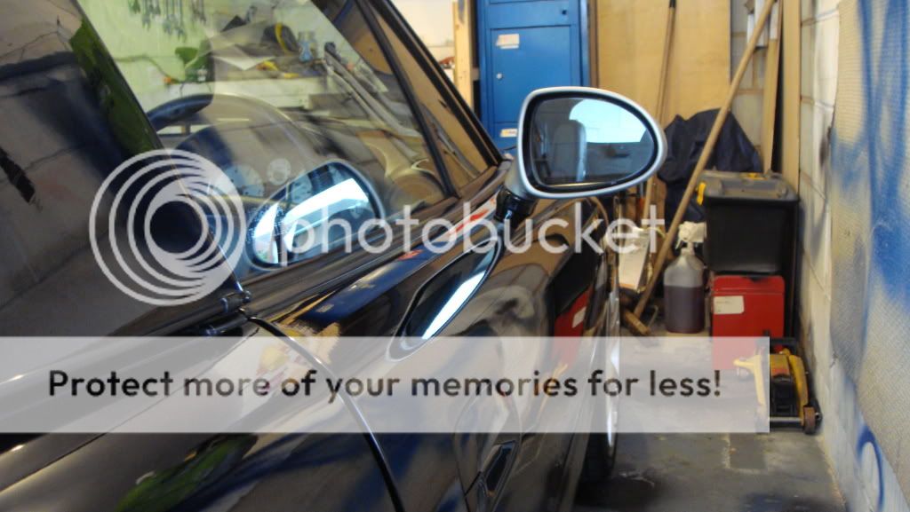

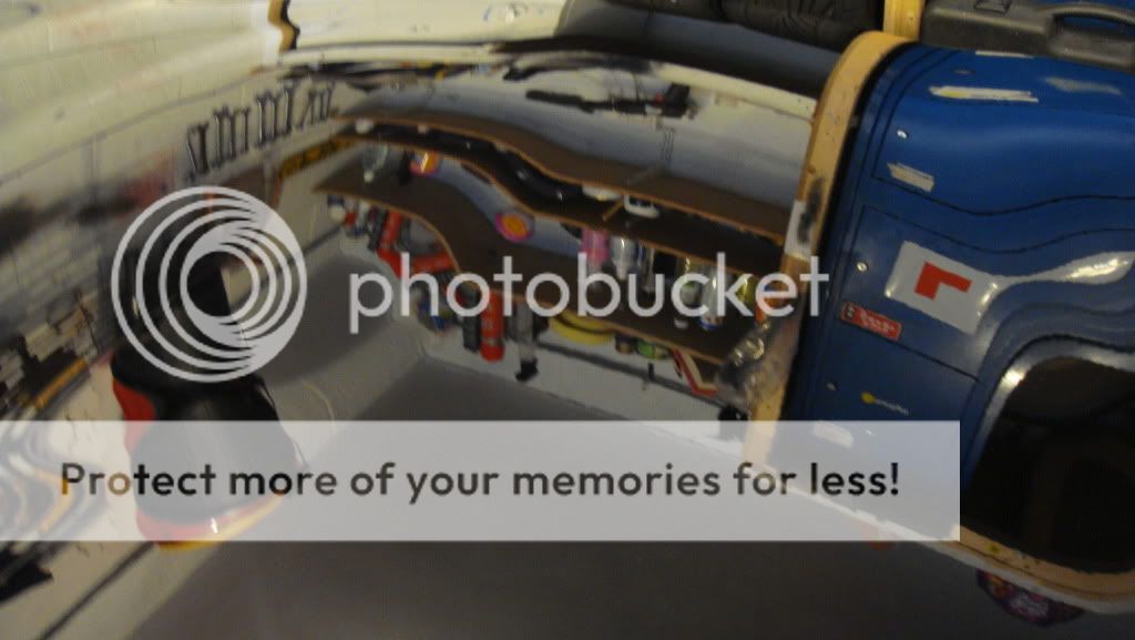

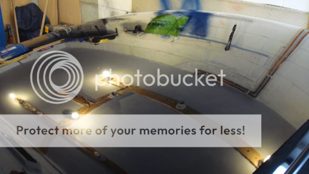

    Some crazy reflection shots when in the garage:

        Cheers mate, much appreciated. Really wish i had got some before and after pic's of the paintwork just to show how flat it was but hay ho, never mind. The cars killed my two Lake County pads and Sonus clay bar though
