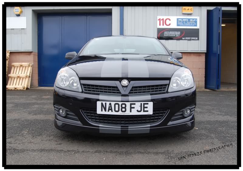

    So this is a few pictures of what the car looked like with the nice venom decals he added a while ago...
    And this is how it arrived..... bonnet decals had been removed by Ian and he'd not had time to completely removed the roof and boot before I started

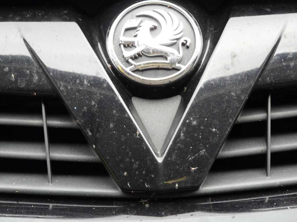

    Nice bugs.....

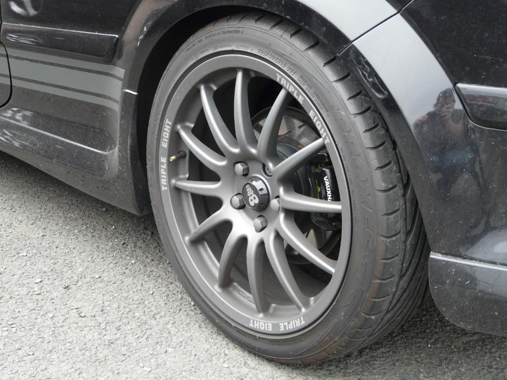

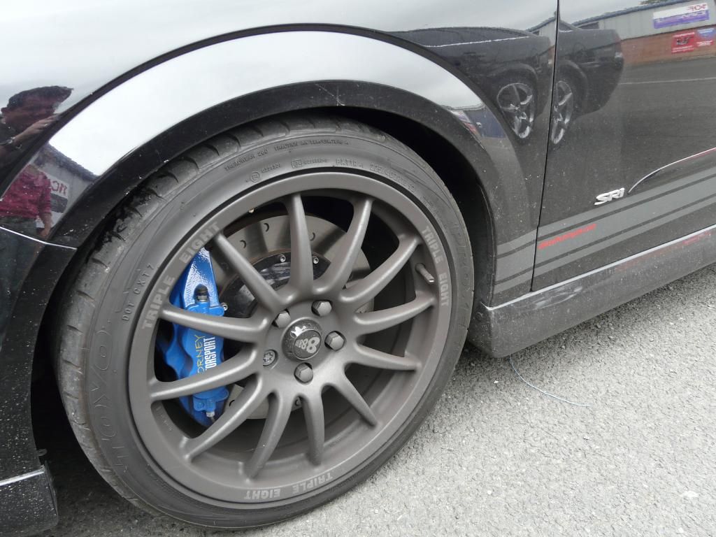

    I want these brakes.....

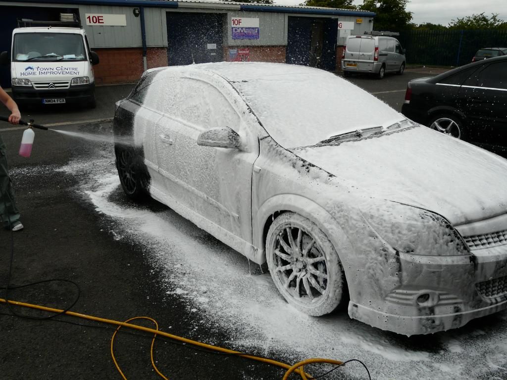

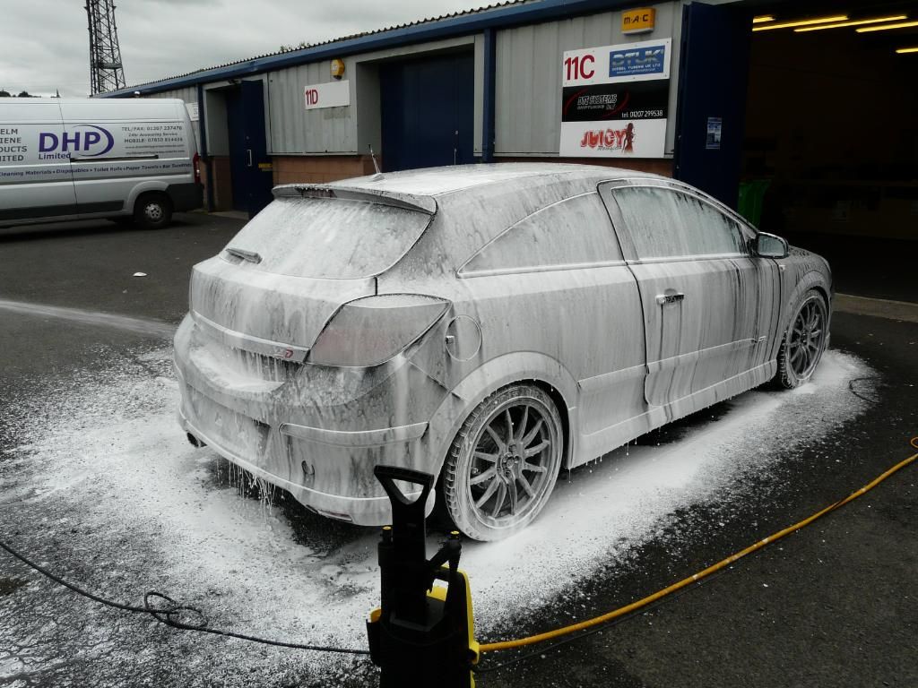

    As there was quite a few bits of glue left and with the state of the car I decided to snow foam with the glue and tar removal in, plus it helped strip off any existing wax. The foam in the lance was a nice brown colour and not as thick as usual, plus the front end and wing mirrors were treated with Chemical Guys Bug and Tar Remover. Wheels cleaned with Bilberry and agitated with CG Gerbil wheel brush
    Rinsed and then snow foamed with just Cherry
    Rinsed again

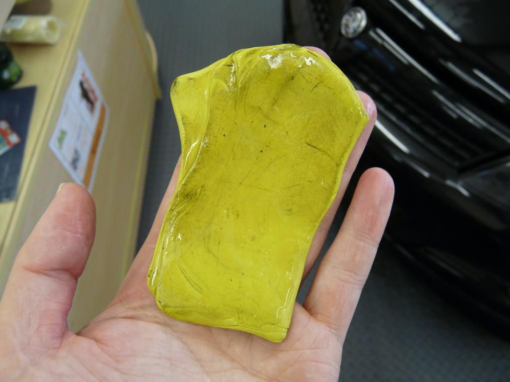

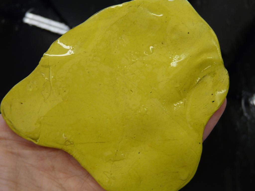

    The car was then brought inside the unit wet and I proceeded to clay the car using Juicy yellow fine poly clay and Juicy Lube..
    Top half not too bad...
    Bottom half ....

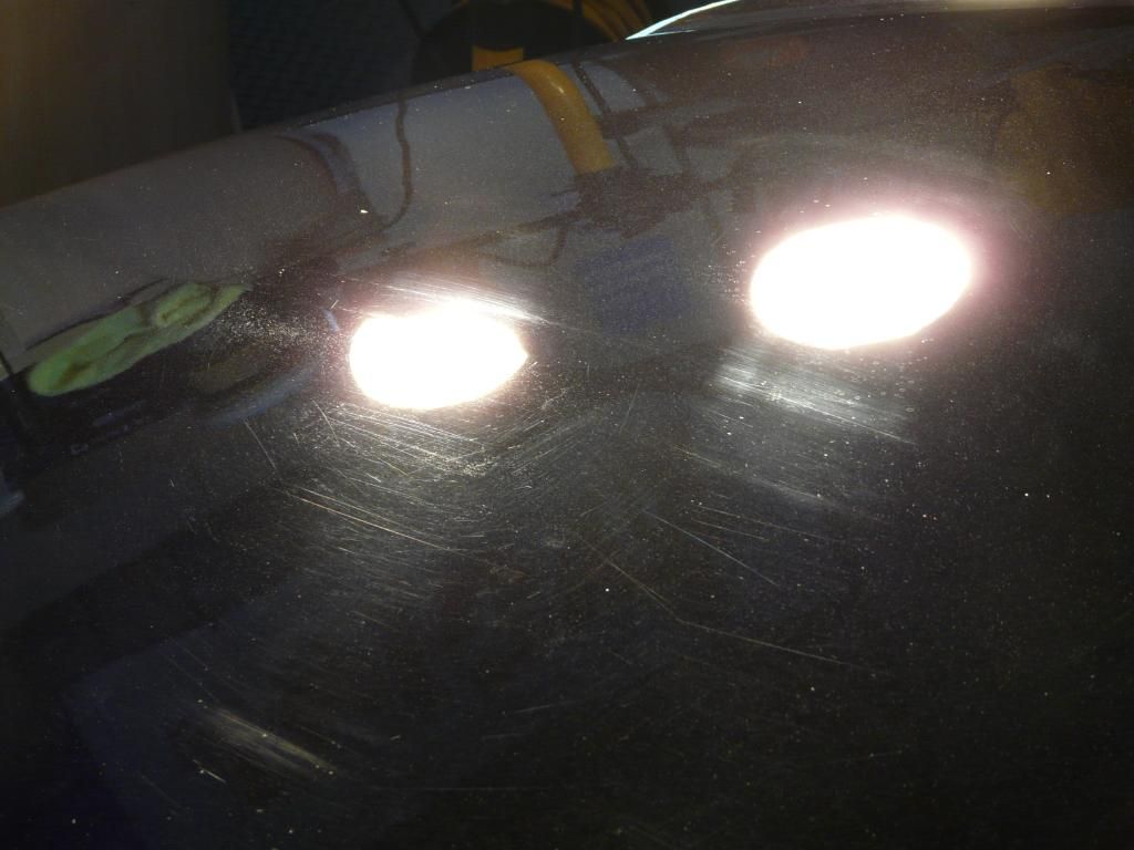

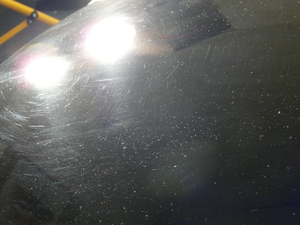

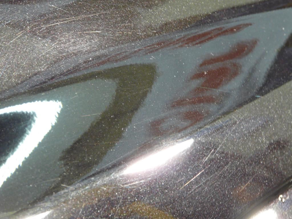

    The car was then assessed to see what I'd let myself in for
    The wings....
    The sides...
    The bonnet..

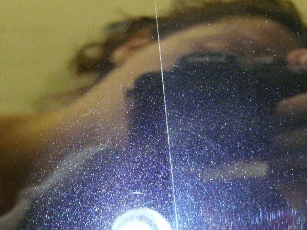

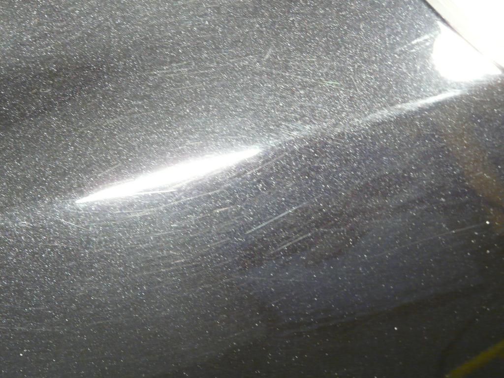

    It seems like company Ian used to get the decals from actually cut them on the car and there are some nice straight cut marks down the bonnet, along the roof and some lovely deep ones on the top of the boot near the window :@
    Oh and a cheeky one

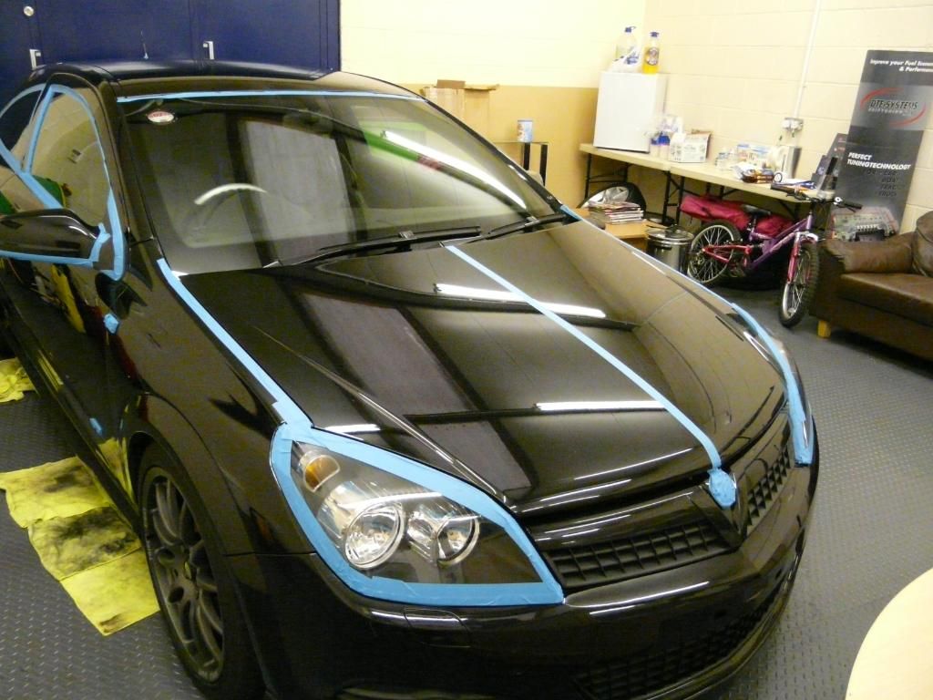

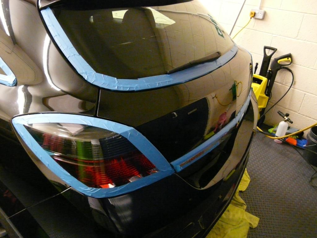

    Car all taped up and ready to go
    That was the end of day one ...finished about 9pm

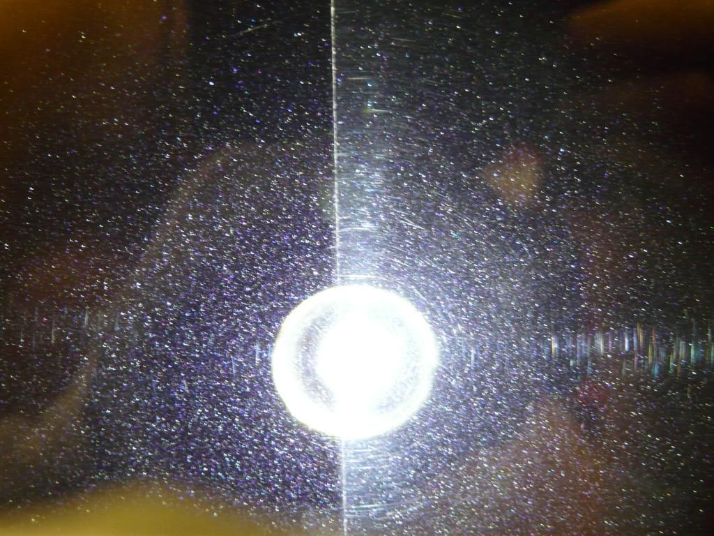

    Test area conducted on the bonnet using a combination 3M polishes and hex logic pads, until I found a combination that I was happy with
    50/50 on first pass on the bonnet

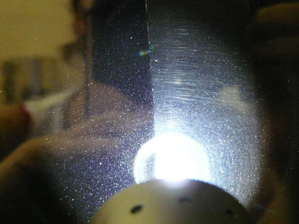

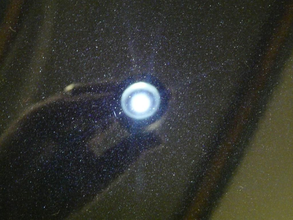

    Needs refining more...the star marks the torch is showing up is micro maring from the polish and cutting pad
    Bonnet after polishing...
    Few more 50/50's as I worked around the car (first, second and third passes)

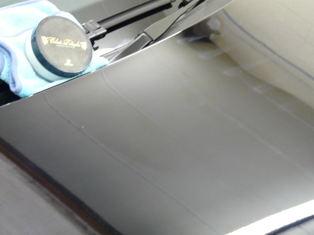

    The car was then given 2 coats of Celeste Dettaglio wax leaving for 30 minutes before buffing off and an hour before the next application. It was applied with a CG UFO applicator and buffed off with a Dri U Kwik Ultra Dense Cloth (sorry for pic quality - was quite tired)

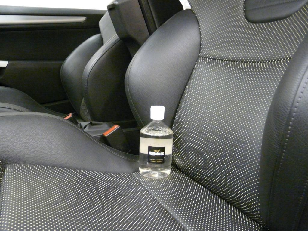

    Sills, Interior and leather was cleaned
