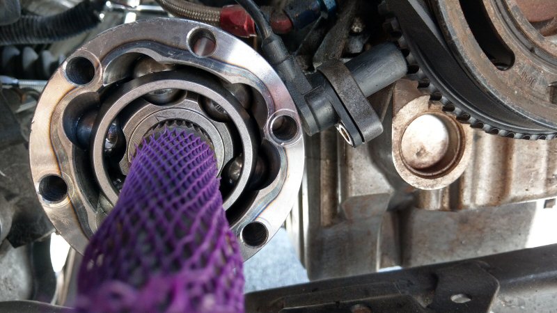

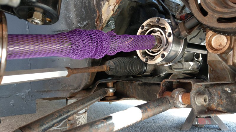

    Fitted to the car with the cross shaft..
    And as i suspected the crank sensor no longer fits, even after grinding some of it away, but we think we've found a non vauxhall alternative which will work.
    A small price to pay for identical length drive shafts.

      Final fit of the cross shaft, and drivers side shaft
      made an adapter for the new crank sensor and mounted it, now have millimeters of clearance!
